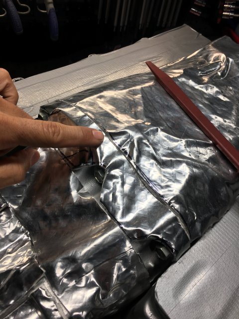

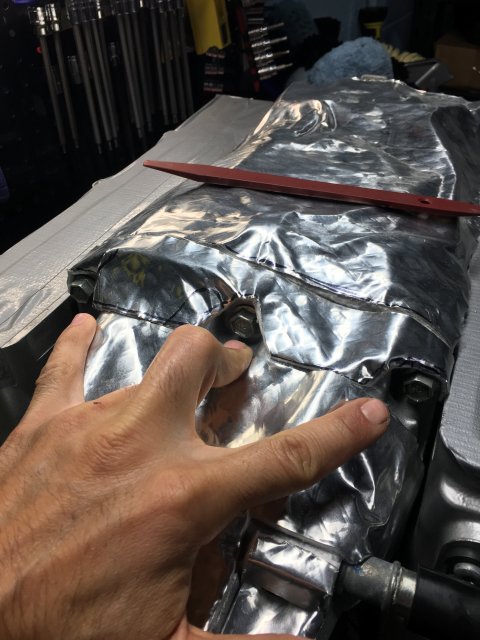

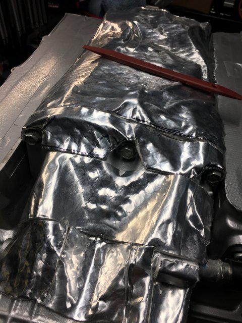

one other tip, I trimmed the heating blanket along the seam where the snout mounts to the blower and I made sure to leave the bots exposed. this way If I decide to do a pulley swap down the road I can separate the snout from the blower without having to remove the heating blanket. Hopefully the pictures will show what I mean.

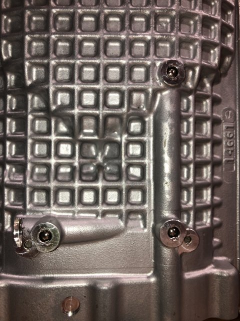

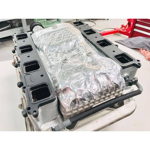

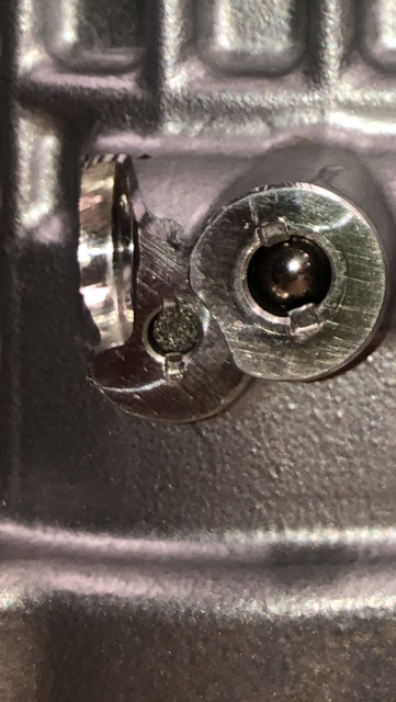

Also @16GoManGoHC2 noted on other posts to make sure you don't cover two relief ports with the blanket or the oil pressure build up won't be able to breathe and you will have problems. He will probably chime in if he sees this.

These, they are breathers connected to gear case and are right behind the seals on the firewall side of the rotors. 5BFF323F-342E-4EF6-9322-5190EE03247C.jpeg 34ED0A0E-57CF-4C74-A1F0-C602C81E4AC1.png

These, they are breathers connected to gear case and are right behind the seals on the firewall side of the rotors. View attachment 18508 View attachment 18509
So are these breathers on the bottom or on the end side at firewall ?...I don't remember seeing these but I wasn't looking for them either.

You can see them uncovered in this pic also. Sounds like they need to put some instruction of do and don't with them unnamed.jpg
