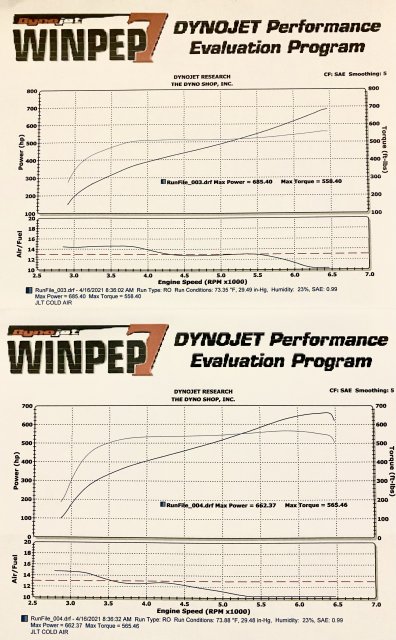

Numbers are in. Not sure how to feel about this. Top photo is with JLT cold air intake, bottom is with stock air intake.
Note: Pulls were all done in 4th, manual, Track mode, ABS fuses removed. I discussed 1:1 in 6th with the technician and he was worried about his dyno topping out at 190mph. Said “we’ll get the numbers we need in 4th”. A83B6639-55B2-426F-AC1E-8CBF3D19B5C4.jpeg

I have no problem with the 4th gear pull. The dyno said it picked up over 20hp lost a little torque and ran leaner. I would like to see what it does at the drag strip making passes going back and forth. If I saw the JLT was faster I would keep it
I will say I'm surprised it picked up that much

It would be interesting to know if there's any actual et gain from either of the CAI's being mentioned.
It at least looks good on paper. :)

The torque numbers are interesting across the pull though. The stocker is making 30 more torque Looks like the stocker is making more power until 6300 rpm
The more I look at it the JLT made good peak numbers but was behind most of the pull

Interesting results, shows the stock airbox works well. Perhaps with some time the car will learn the JLT and make more power over the curve along with the boost at peak rpms

Fueling is likely COT.

We did the same thing on our racing Duramax diesels years ago. We actually saw 13-17 HP on the dyno. At the track we saw nothing. Not even a tenth. Funny thing is; we still use them. LOL

I’m of the belief that any dyno pull comparisons of air intakes with the hood open are pretty meaningless.
