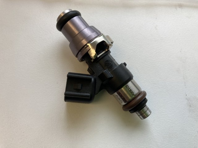

Thread Starter #99
ID1300X2 where designed with flex in mind and idle and part throttle stability when on gasoline. It’s what I originally planned to use and had a set but sold them when I found a tuner that said by 1050X’s where plenty for E85 and 17 psi of boost I sold the 1300X2’s to fund the tune.
28B08231-4250-41DB-930B-75BB8D0D1E7E.jpeg FA61C669-DA3E-4492-84CB-61585453C03E.jpeg 033F95C1-4970-41E2-BF7B-A1C7F7D8430D.jpeg

As in ID 1300's??
Yep. Those.
The ID injector data and their consistency is a big reason why they're popular. It makes that part of the process so much easier and in the hands of a gifted tuner the idle/part throttle is as good as you can ask for.
