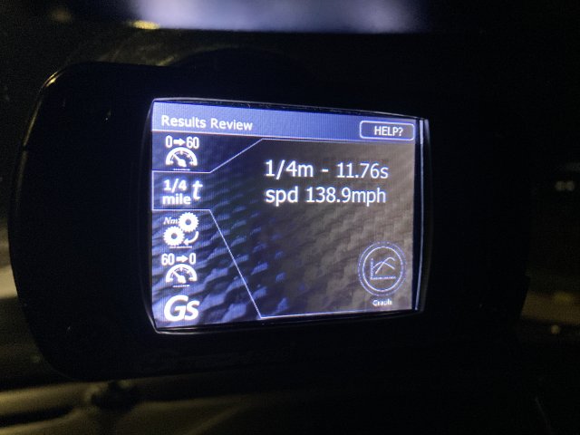

Did just that last night,reloaded a 93 tune to set it back to zero. It went right back to 64-66%. Put the FM 95 TB on it, did the same reset and it went to 73.5%. I just added 12 gallons of tested E80 this am and it went to 77%. Fuel trims at idle almost 0. I think I’m going to leave it this way for a bit. It’s showing it’s making power, 1/4’s are back up to 138-139 mph :) from 135-136 when it didn’t seem happy. All this testing took place last night from 5 pm until 12:30 am, I just had to know while atmospheric conditions where the same. This am just went and laid down 2 1/4’s in the 138-139 mph range again even with super shitty 4.8 0-60 and 2.4-2.6 60 fts
On to Halloween party preparations in a good note!!! It’s 35F here, traction is VERY limited lol F9601106-ED06-4841-8937-5AC5E6EBC67C.jpeg AC473628-B117-4431-945B-CECF3CE5CAF5.jpeg
