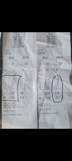

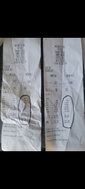

Last week 1/4 mile Screenshot_20230506_133457_Gallery.jpg Screenshot_20230506_133451_Gallery.jpg

Looks like where my car is at the 8th, you must be getting real hot up top. Probably need more cooling mods, but if you have a chiller idk. Are you using good canned e85?

60’ is everywhere

You didn't answer if it is spinning or just not leaving hard
1st gear spins. Second gear doesnt leave hard.

Op… what are you complaining about? You just posted 60’ literally all over the place… 1.7… 1.6… the 1/4 mph does seem a bit low, but honestly might need a driver mod
Not complaining. Seeking advice. Im sure a driver mod would be great. And im seeking advice on that.

Have to see what Jon finds out. MPH way to low for the mods

Exactly why I asked about the mph and showed those time slips where I ran high 9’s (we are yet to see the time slip to do the math). Sixty ft isn’t just about hooking up. You also need to have the power to accelerate and if there’s a issue then it’s going to show up from the top of that time slip to the final mph. I don’t see where the 134 mph number was shown. That isn’t all that strong for a modded e85 motor unless the da is real high. I think there’s more going on than just traction.
Slips have been uploaded and my et mph is betwern 132 and 134

Even with a better 60’, it looks like you are not making enough power to get in the 9’s. Your 1/8th mile and 1/4 mile speeds are low compared to the ones MarcW posted in an earlier post. You need a better 60’ but maybe you just have lousy DA? Is your trans tuned for different shift points?

Yes Jon tuned my trans as well. 6500 shift points.
The only thing i know to do is wait until Jon reviews log files, unless someome knows a way for me to pull them and view them myself.
The DA on the 1/8 mile slips i uploaded from yestersay was 2200-2300
