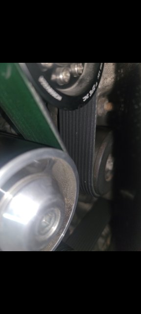

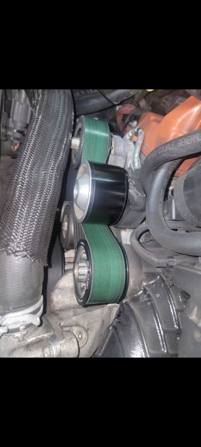

Just a quick update. I haven't abandoned this thread. Im a travel nurse and have been on the road last few days. I return home tomorrow. Were checking a couple things. Firstly were going to Investigate for belt slip. Being down that much boost it seems itll be obvious if that's the culprit. Additionally Jon has provided another tune i havent gotten to load yet, where hes increasing voltage to boost relief valve to keep it closed instead of bleeding off so much boost. Ill post pics of what I find tomorrow morning regarding belt slip. Thank you yo everyone trying to help me get this thing into the 9s and sub 1.5 60ft.

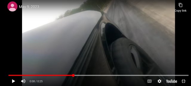

watching your video's I do not see a lot a lift in the front
Disregard the crappy track. I will not be returning
What the heck kind of track is that. Looks like some sort of backwoods kind of deal. I think we need to find you a real track
I agree. Bare in mind.?. My time slips arent from that track. I only posted the clip to show front lift? The previous posted clip is from our local 1/4 mile track in bristol

Ok so me pushing 18psi i shouldnt be having that issue. I wonder if its just where we tuned it for e85 in winter and now its summer.
Btw heres some pics of my belt.
