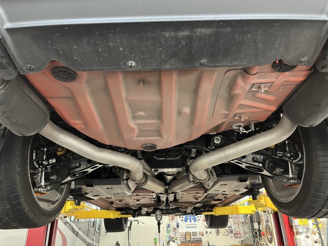

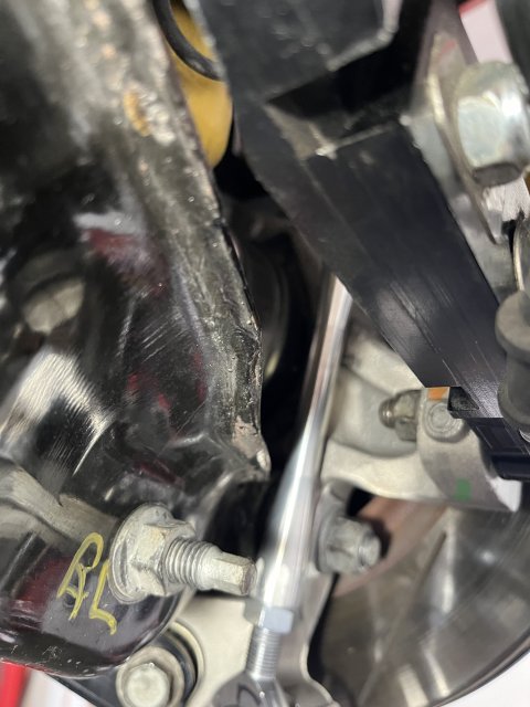

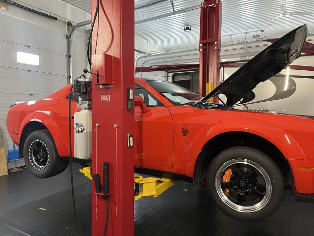

I’m not sure of the “proper” procedure for aligning the cradle when reinstalling but I hung a plumb bob from each side of the car and measured to the centre of the axel stub then also measured from the centre of the axel stub forward to the same point on the car on both sides.
I managed to get the cradle cantered both side to side and front to back within 1/16” or 1/32” per side so that should be good enough and I will be getting an alignment done anyways in the spring.
chrome-extension://efaidnbmnnnibpcajpcglclefindmkaj/https://www.bmrsuspension.com/siteart/install/CB005.pdf
Everything is looking good!
