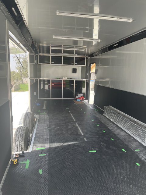

It looks like the weather is finally on our side. Just figuring out where to install the etrack and the car goes in Wednesday for an alignment. Weather permitting I have been invited to a private track day May 9th !! IMG_7932.jpeg IMG_7928.jpeg

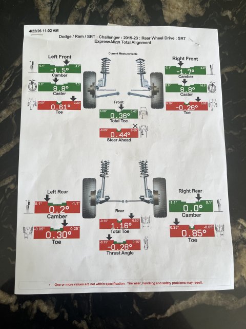

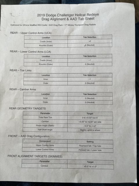

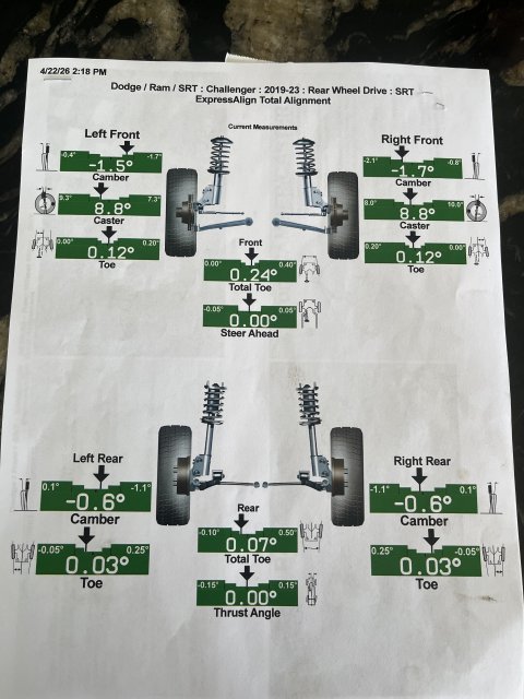

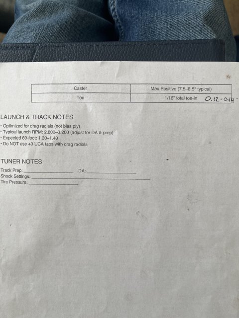

So I actually found specs that are supposed to be “optimal “ for my Gforce modified cradle set up and I had my car aligned today. Everything seemed to work out fine other than a possible u-joint that is failing and the likely suspect for the noise I was hearing. So for what they cost I am just going to replace the u-joints and hopefully that issue will be solved, but you never know. IMG_7940.jpeg IMG_7941.jpeg IMG_7936.jpeg IMG_7937.jpeg

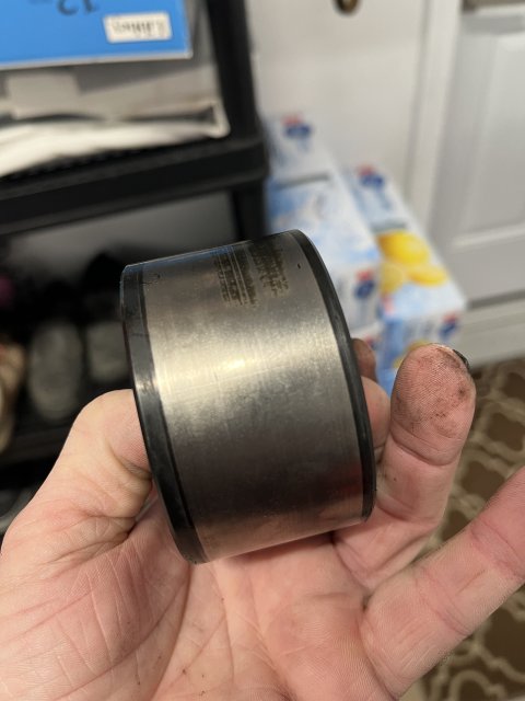

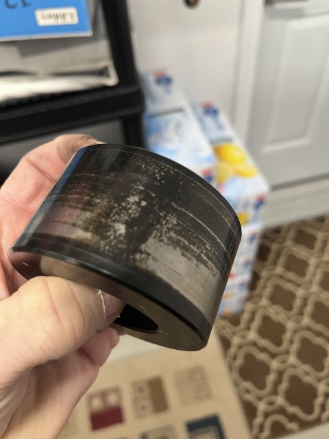

So I decided to replace the tensioner and idler pulley with the Metco product as I did notice that although the bearings seemed ok it was visibly obvious that the belt had been slipping on the pulley as seen by the pictures below

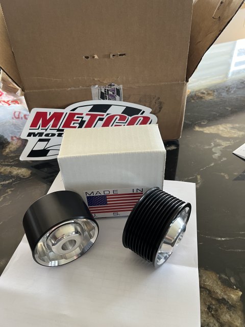

Thread Starter #111
The Metco pulleys not only looked a lot nicer they were considerably lighter. IMG_7974.jpeg
