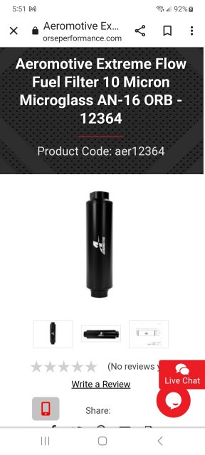

The one in your car is 10 microns? Got a pic and a link to it?

One I was looking at is washable metal mesh

16 an is huge. Who did the install? Do you know what fittings and hose they used? Where did you mount it at?

My guy installed it when the dual pumps were put in. I don't work on shit anymore. I have no patience.
