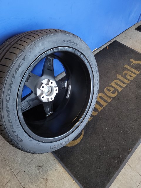

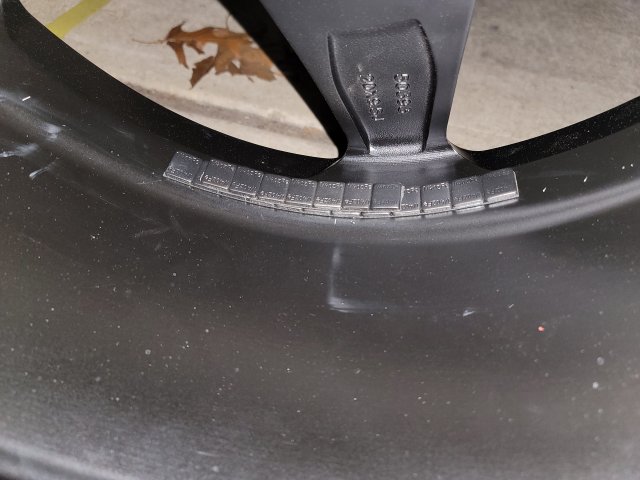

Idk I got different tires and now there's even more wheel weights. Wonder if the rim has more weight on one side than another... think I'm going to take it to a different spot and ask them to see if they can do better.
To me this isn't acceptable but idk 😐 😕 🤷
That is awful. Like mud flaps on a gopher's ass.

Pic of the 'dot' on the tire in relation to the stem & those weights ?
There are no dots on the tire, if you are referring to the red and yellow dots I see on tires for mounting and balancing.
And the wheel weights are 180 degrees from the valve stem...
That is 1/2 the weight of another wheel. Turn it inside out.

Tell them to line up the triangle with the valve stem and rebalance it...should be much improved.
Does that have meaning beyond pointing to the wear bar/indicator ??

I have found there is a heavy and light side to most tires. Looking at pic, all the weight is to offset heavier side,(Valve stem area,) hence the reasoning to move the tire the 180* and rebalance...the very worst is the same weights would be on other side...but I suspect a noticeable reduction will occur as the stem/tps should about weigh the 4 oz of weight currently on it.

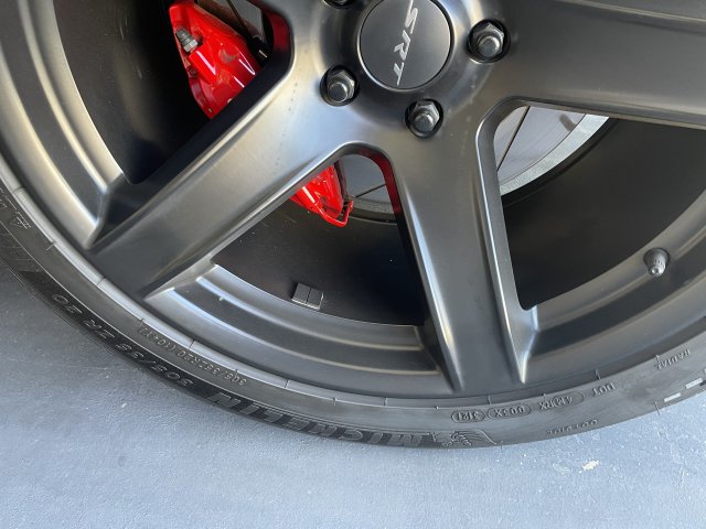

Don’t want to rub it in, but this is how my guy rolls! :) 24B03B2D-6600-4A08-B0F7-C5DC9DBC515B.jpeg
6,854
12,738
Sheesh, Eric, he didn't even bother to tell the machine to hide the weights behind the spokes?
Dummy
1,981
3,974
Next time I'll drive on up for a free install ;) Annette hasn't broken my time record yet has she?
6,854
12,738
I dunno, Eric. She hasn't mentioned anything along those lines, but that doesn't mean much.
Last time she drove a Challenger was in my measly V6, by the way. No records to be had with that one, except in mileage.
