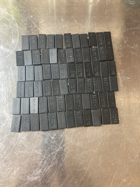

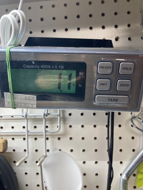

just pulled all these weights off my weld 17” single bead locks With no tpms. I think they got carried away with the weights. Going with the crimp on the lip style weights this time, tired of scraping all that glue off. 1.1 pound of weight is crazy!
