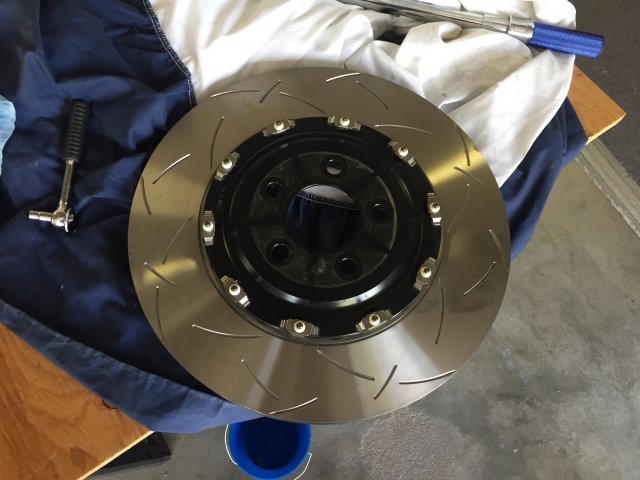

To begin with, disassemble each rotor, removing the hat, from the disk. You will need both ratchets, with Torx and 10mm deep socket.
My rotors were apparently built on a Friday afternoon. If my hardware configuration looks different, than yours, make a note and re-assemble the way yours are built. That's what I did.
Once the hat is separated, from the disk, you will want to remove the H-bobbins and spring clips. The spring clips slide right out.
I wire brushed the hat and painted it.
While that dried, I took a wire brush, to the H-Bobbins, to remove all the brake dust.

Once the hat was dry, I installed new spring clips and the cleaned up H-Bobbins.
Once complete, mount the hat, to the disk.
Use a small amount of thread lock, on the first few threads, of the bolts. Tighten them, in crosswise pattern, to 65 Inch Pounds. DO NOT OVERTIGHTEN THEM.
Now, you're finished and can re-mount, to the car.
Hope this helps.
Bob

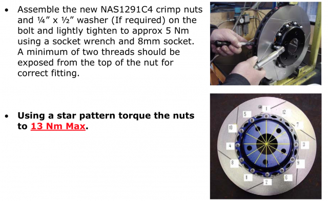

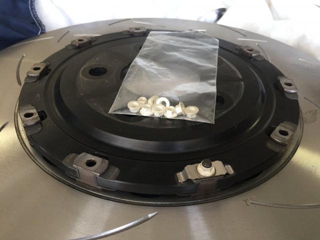

If you go DBA, here’s the nut torque info. It’s easy to do yourself. Just a little tedious and I used a bit of blue Loctite. They also send along new nuts. Nice thing about DBA is they’re non-directional so you can’t mess up which side you install them on.

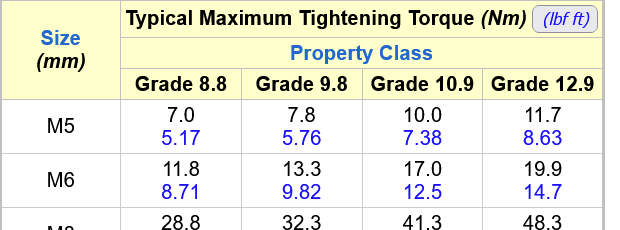

My input on the subject is that there seems to be a torque discrepancy. However, on hardware like this, different hardware can make a notable difference, so keep that in mind.
I've seen values from 65lb-in to 100lb-in and even other values as well.

M6 is the size of course, which grade is critical, and you don't want to use 100% either.
CDT is currently using Grade 10.9 and recommending 120lb-in, but this is not directly applicable to the above information.
The torque info I used was supplied by DBA. 13 Nm = 115 inch/lb or 9.5 ft/lb.
