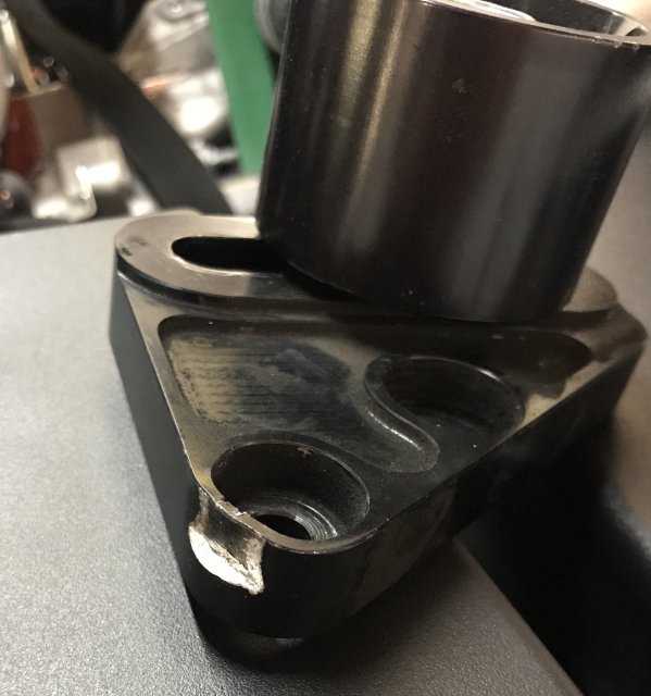

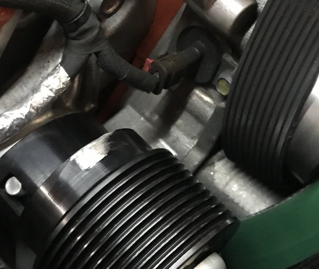

Marc, where exactly are you grinding on the tensioner if you don't mind my asking?
The tensioner has been slamming against the mounting bracket for the Whipple idler pulley at WOT. It had created a notch that finally got to the point where the tensioner was wedging itself under that bracket and not returning to its off throttle position and keeping tension on the belt. The result was it would throw the belt on the second gear shift. After we figured out what it was doing, we ground the area where the contact was until it was eliminated. EF73026B-0A5F-4B4F-9076-63ABAE6D33CC.jpeg 67949D50-90D5-4D66-98E0-28F95E7E5F91.jpeg

The tensioner has been slamming against the mounting bracket for the Whipple idler pulley at WOT. It had created a notch that finally got to the point where the tensioner was wedging itself under that bracket and not returning to its off throttle position and keeping tension on the belt. The result was it would throw the belt on the second gear shift. After we figured out what it was doing, we ground the area where the contact was until it was eliminated. View attachment 35356 View attachment 35357
Indeed, rapid engine deceleration will pull the tensioner fully tight so hard that this can happen. Interesting work around, thanks for sharing!
I never used to throw so many belts or break tensioners until I switched to a grip tech pulley. The slippage I used to get before with a normal pulley was helping save parts but that also meant I was leaving some power on the table because of it.
I was going to mention that! This happened right after we went to the Griptec. First time out after. We were seeing some belt slip and made that change. If you go to the ARS, you will want to keep a eye on that area of contact. We had no idea until the tensioner arm stuck in the in position and stayed there. Picked up almost four mph with the Griptec (after we fixed the tensioner). I love Griptec!
Indeed. Somewhere here I have a video taken with an engine compartment camera of how violently the tensioner gets slammed around on WOT and WOT-let-off that it is painful to watch.
