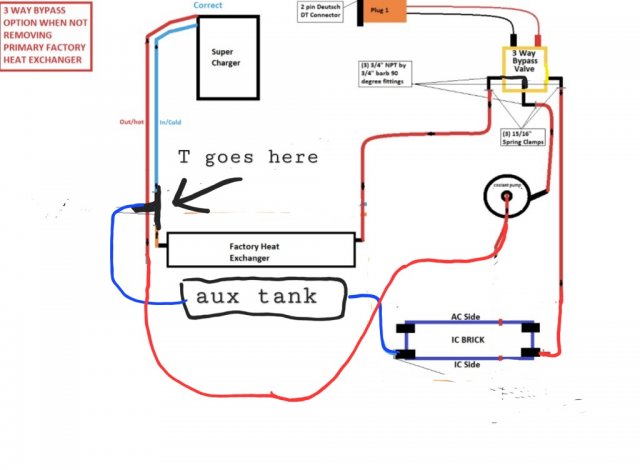

I read you guys post every night....I'm wanting to buy the chiller and get the aux. tank with the crash bumper.And I dont want to feel dumb but I'm 68 and this new stuff get the confused. I guess what I'm trying to say do I need to get the 3 way valve? And if I dont get the 3way valve I wont need to put a switch in the car....or am I reading to much into this. I plan on keeping the stock heat exchanger.

The drag valve and the 3 way valve are to different things correct? or is the switch inside the car for the darg valve?

Yes 2 different things. Drag valve shuts off cabin ac. 3 way valve bypasses the heat exc. I use the 3 way vale in my system. When its hot in summer time it was taking a while to cool the cabin. I have 2 drag valves on mine, one works with the 3 way valve. If I use the heat exc it will shut off the chiller system. Once my cabin is cold I turn on the chiller and everything works great. Also in the winter time I rarely use the chiller. I over complicated my system but I like my ac ice cold.

you and I are different there I dont even use my ac always have windows down just old school I guess.So the drag valve the system is always using the ac for chiller?

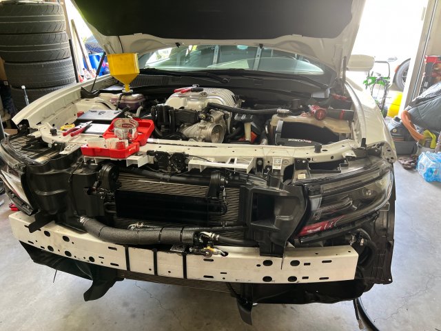

Just a few pics of my install 67425420720__A1A53747-C9F4-42CB-AE18-6E00EB1D1B36.jpg IMG_1212.jpg

With IC Chiller, you don’t have to cut suction line. With Forced Induction interchiller (even the p&p kit) you do. I have my stock AC lines and can put the car 100% back to stock if I wanted/needed to
