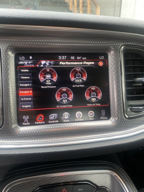

We are pleased with the performance of the ic chiller ,this was for @Doublewide 16 challenger without an auxiliary tank ,we saw 50 degrees without the drag valve and 35 degrees with the drag valve on and ambient he runs a 2.65 upper and 9 percent lower with ihi blower , I’m sure with some insulation of the lines it will perform even better!
I also want to thank @uncrnps (summit) for excellent support
yep, I run no aux tank, 2.69 upper and I can get it COLD (23 degrees with drag valve) have ALL lines insulated, gets cold fast
