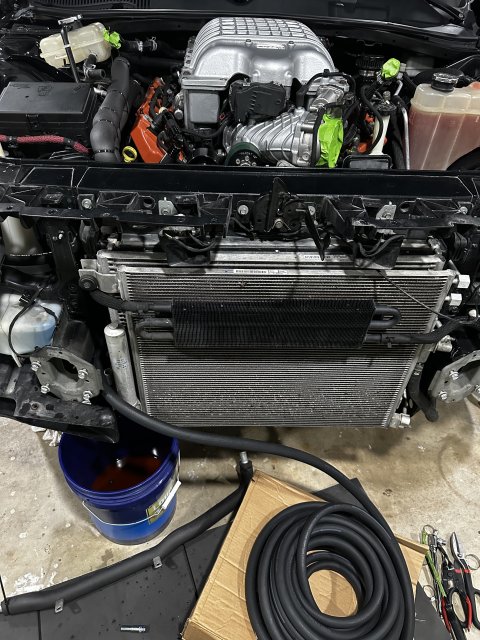

Hose came in. Decided heat exchanger is getting plugged off completely. If I change my mind, I’ll have plenty of hose left lol. Keeping the bugs on the condenser, adds character

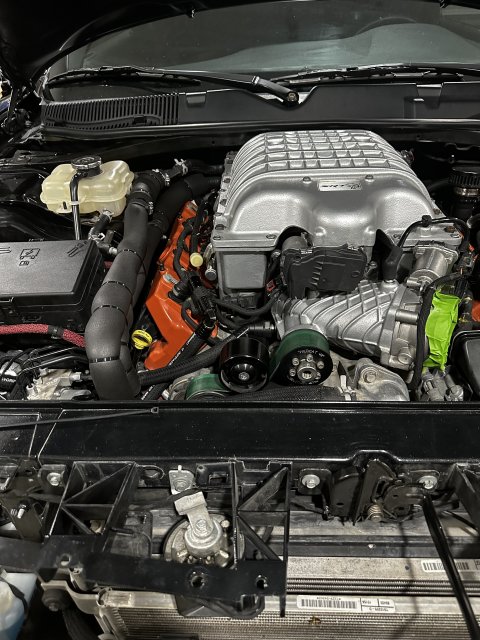

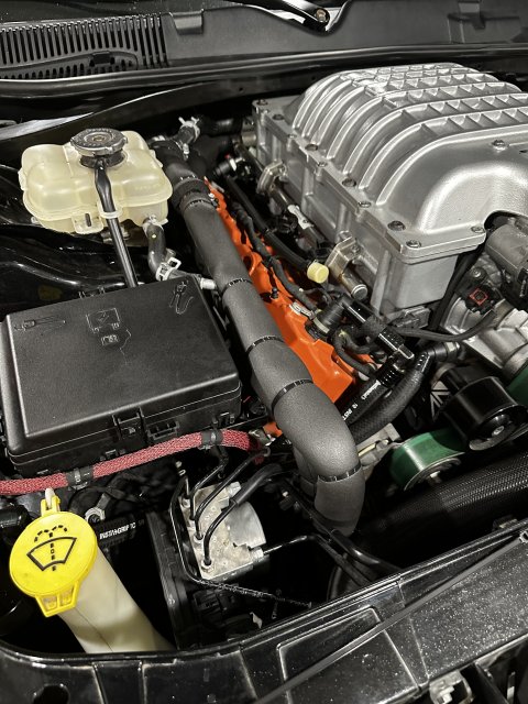

Insulated good enough I’d say
3,716
8,784
Are you guys wrapping (insulating) all of your lines (too hot line included) or just the bottom cold line going into the supercharger?
I insulated everything including the pump housing.
U
8,599
7,567
Thread Starter #46
Oh wow. Do you know what the stuff is they use to cover the chillers/aux tanks? They’re rubber insulation in sheets? Looking for some of that

I also used the more expensive wrap which is smaller in diameter and bends/molds easy
3,716
8,784
McMaster Carr has adhesive backed foam insulation sheets, I used the 1/2” thick stuff
