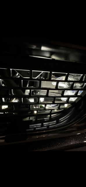

Just got plastic sheet to close off wheel well vent

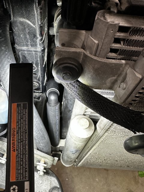

Thread Starter #85

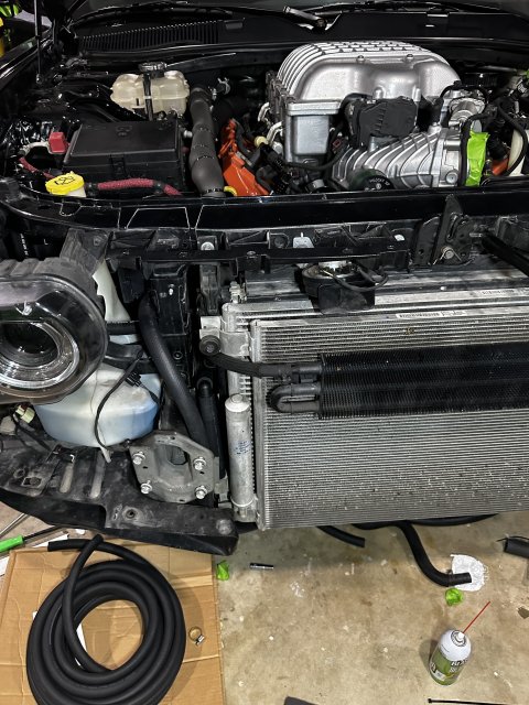

Juuuust clears the bottom of the bumper - brick actually rests on it. Don’t run anything over or it’s toast lol. Way more room up front then I though - might change plumbing a bit

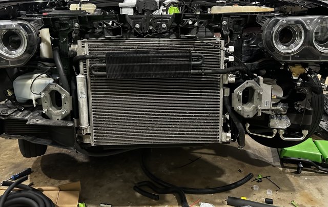

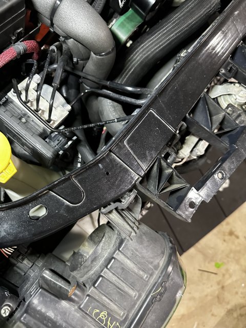

Thread Starter #89

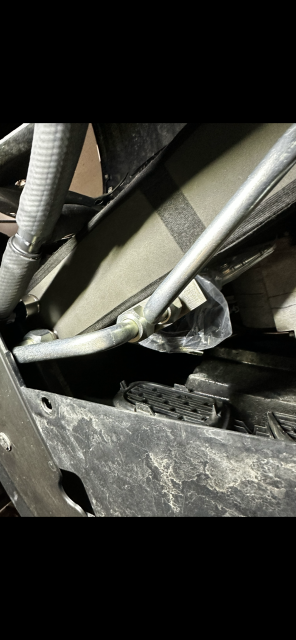

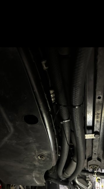

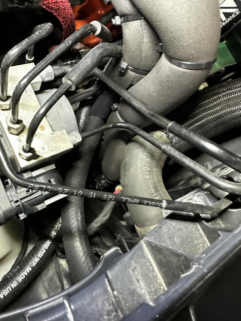

plumbing is almost done finally. All routed through under the car. L coming off heat exchanger on passenger side of car under the car to chiller line, L coming off of cold side supercharger hard line on passenger side, hose running by headlight/down behind crash beam and under the car to the chiller. Just need to insulate and clamp everything down. Chiller side for bypass is all done. Amazon is late so my new fittings for the chiller won’t be here today smh

If you’re running the 3 way valve, it’s a bit of a project for sure to figure out the plumbing and route everything the way you want it. I will say the hard lines for the TXV get in the way, and limit how you can route your water lines.

If you have an good budget, an fitting like @fumanchu182 ran are the way to go. Thankfully retaining the factory hard lines gives me some good locations to take it all apart if I have to. Current situation under the car : hardline (hot from supercharger to pump), heat exchanger (flow is reversed from stock, this is from passenger side to the T) and cold side sriracha front the chiller uo side of condenser/near headlight and to bottom of cold stock hard line. Still need to insulate and tie everything down, this was for mock up

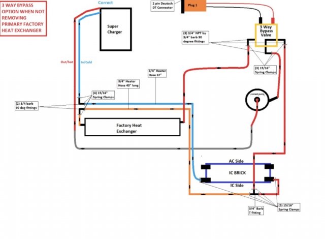

Since you removed the air to water heat exchanger (little radiator) Where did you route the other port of the 3 way valve too then?

The other side of the big heat exchanger. So the big heat exchanger is “bypassed” (fluid will not flow through it end to end) during normal operating, and then fluid is directed into it when button is on

This is the diagram I used, set it up pretty much exactly like it. This is the “updated” diagram from IC
