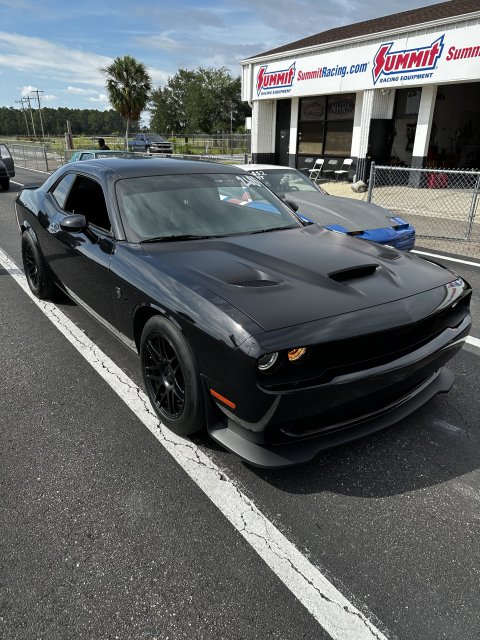

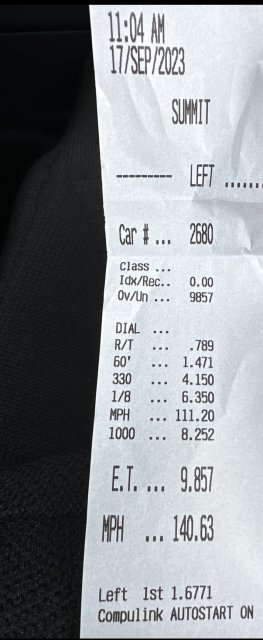

Chiller worked it’s magic. Pb on 60’ and et by a little lol. Car is very consistent when it hooks. They had to scrape the track for an hour because someone blew their diff at the line. Shook wheels twice. These passes were clean IMG_1894.jpeg IMG_1902.jpeg

Thread Starter #180
