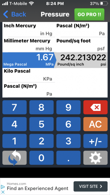

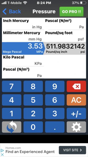

I received in today a spare Mopar AC compressor, look at pressures listed on the tag. That’s some high pressures!!

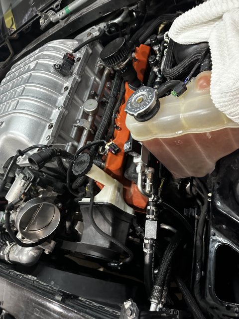

Jumped the gun and started ripping car apart before I had it evacuated. So it’s all installed and plumbed coolant wise, and now that 3 way salve is wired up should be fine to drive to shop. Also a good test to make sure nothing in the water side leaks. Hoping for AC lines to go smoothly

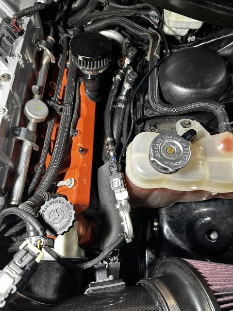

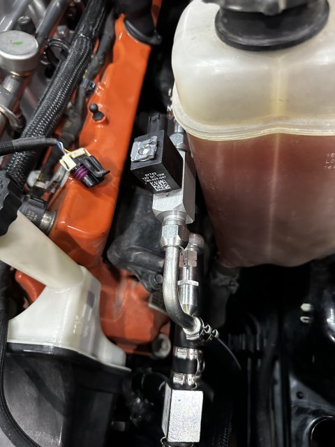

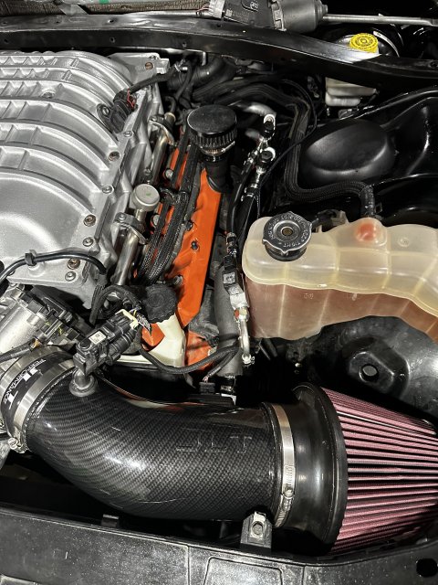

Done!!!
U
8,590
7,563
Thread Starter #136

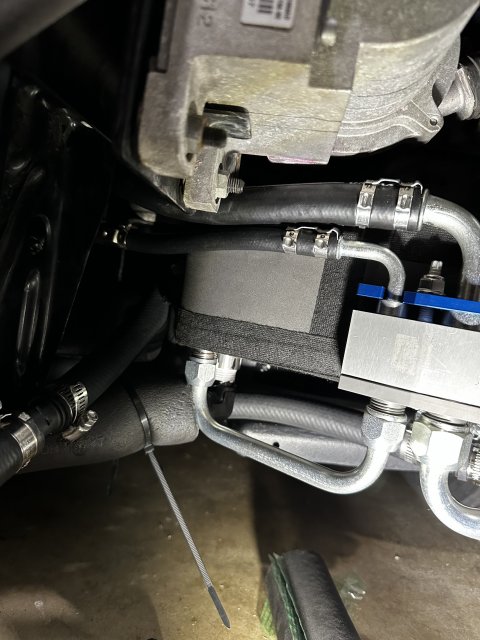

Ac lines are very straight forward and easy to do, took a few hours screwing around. Make sure you index everything with a marker, take it off, and then tighten the cnc fittings to the screw on hoses - makes life easier, and less chance of it coming loose. I used some left over pag oil to lubricator washers and o rings. The biggest feat is the plumbing for the 3 way valve. It’s a pain, but I can confirm it does keep the IATs and car just as cool as if it wasn’t inline when flowing through the heat exchanger. Big test is when I get it recharged 🤞🤞🤞🥶🥶

Also not a bad idea to mark your hose, cut, and crimp outside of the car - very easy to route the AC lines fully assembled

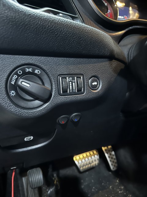

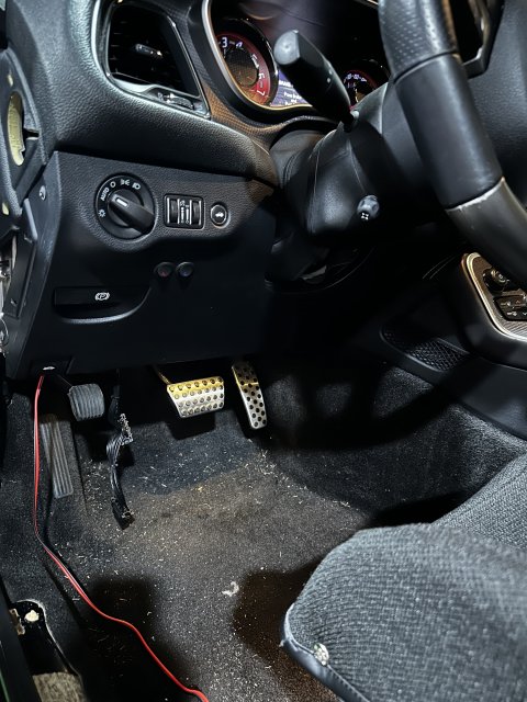

If you have a switch go bad let me know I bought a 10pk of different colors off amazon. I had 1 go bad on me 3 months into using it.
Thanks man! Will do! I actually want to get custom billet switches but my cars not nice enough for that, heck it has a plywood rear seat delete 😅🤣

I’m more worried about all the coolant lines than all the AC lines (no leaks!) if a hose go bad, besides having it evacuated, it’s small potato’s to change them out. I feel like I could plumb this all up again in a day, hours if not using the bypass. A lot of time was spent trying to figure out all the plumbing
