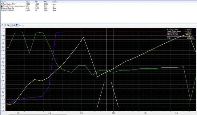

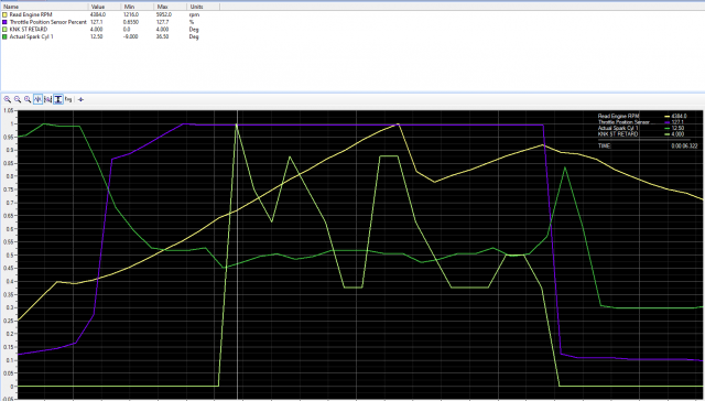

I went and found these logs from some summer street testing back in the day. This was June in TN so figure 90 degrees and humid.
First log is on Shell 93. Knock all through the WOT pull in 3rd gear.
Added unleaded race fuel to bring the octane to about 100 and re-tested. Almost zero knock.

Well just another reason to run e85:p

Forced induction is more to dial in than people think. There’s a point where you have to much timing and more air charge will help. There’s a point where there is to much aircharge and timing would help. I almost wonder if dodge went up just a small amount in boost and pulled a degree or two of timing if that would have helped and could have made the same or similar power. Makes me wonder if the redeyes have the same issue ?
Obviously, there are many people who are running a 2.85 and even smaller pulleys on 93. As long as these aren’t max effort tunes 11 to 12 degrees of timing on the big end and you may not see any knock.
Just a thought. More air may have been the answer. But that would have made dodge step up Injectors and dual pumps in the hellcats to. Then you get into an emission issue. So that’s my thought. Dodge should have turned down timing and added more air.

Dodge wanted to claim a 700+HP car off the show room floor. That's what this is. If you look at the later year Hellcat tunes, and the Redeye tunes, you'll see they reduced timing a bit. It doesn't take much to dial in right on the edge of knock and stay below it. So that 4 deg of STKR I saw in my above log, taking out 1 degree of timing might have gotten rid of all of it. Once knock kicks off it can be contagious LOL.
Custom tunes and pulleys from reputable tuners you won't see as many problems these days as now they know where the timing and knock sensor limits are to avoid them.
If I were reviewing a log from my 2016 Hellcat bone stock and it was a modified car I was working with I would have pulled 3deg of timing and tested. If that worked I'd add one back and see what happened. I also would have never set the commanded PE fueling to 12.1 AFR, more like the 11.4 - 11.8 we talked about previously.

i do the same. See knock pull some and see what happens. If I am correct the 2018 had some small supercharger improvements and you had stated the 18 is a little less timing. So they could have had the same thought I had.

In any case they saw a problem and made changes, otherwise there wouldn't be the changes right?
Someone with a newer model could do the same testing I did and see what they see. Most people don't understand data logging and think hooking a computer to the car will void the warranty so it's better to just recommend putting race gas in the tank and let'r rip.
