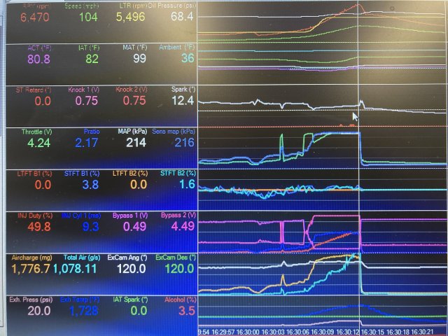

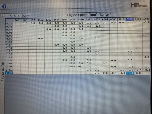

More of a OCD issue then a knock issue lol. On my Flex tune I refuse to go any higher then 1.600 volts on my knock sensors. @jonx96 made this graph for me and plotted average knock. For the knock sensor settings and on straight 93 no octane boosters (no more of them for me, I’m going to splash 12 gallons of 93 with 2-3 gallons of E85 for about a E25 mix and that’s going to be my octane booster!!) and making about 825 wheel and 6.26 second 60-130 times on these timing settings on 93 I should just leave it alone lol. My mystery is why sometimes it runs totally clean STKR wise and 10 minutes later on return 1/4 pass same bridge just opposite direction I’ll see STKR. But if I do a pull in 3rd gear alone or even a 3-4 pull for a 60-130 run no STKR but in a 1/4 pass same weather conditions I get a degree or so of STKR blips. That’s what I’m trying to solve.

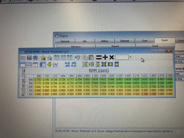

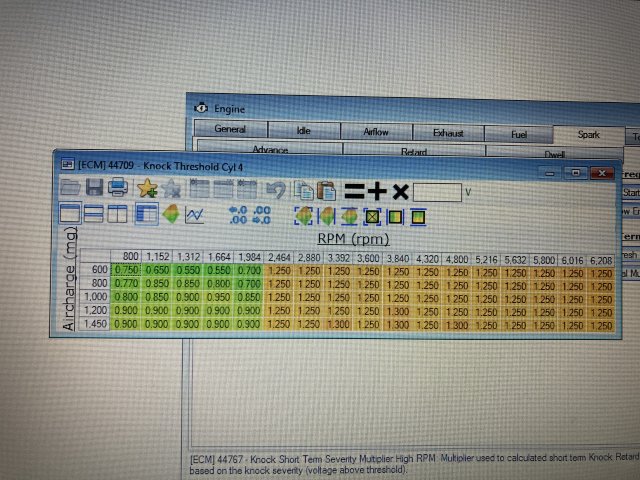

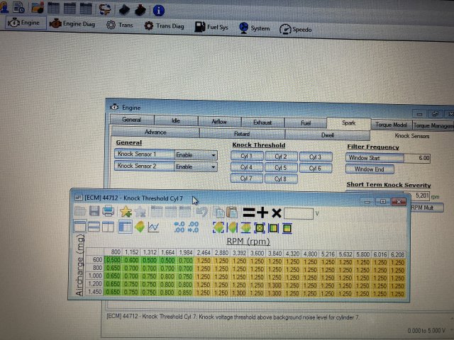

These are my high and low knock sensors and timing at various aircharge. I know I could bump up the knock sensors a bit but trying to find other ways to quench it. I’ve even had thoughts my stock damper I used may be some to blame and harmonics might be coming into play. Putting a stock size ATI Superdamper on now and come hood roads see if that makes any difference at all first.

We also talked about a few settings to make it so his alcohol% isn't searching around as much as it is. I think this log changed 10% or so during this drive back and forth. I don't have my percent changing that extreme during a drive.

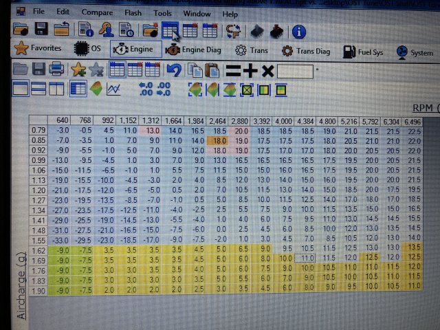

I’m alway open for safe experimentation. The 93 portion is based off my original HHP tune that ran for 2 years on 93. I’ll find and post that timing map for comparison, it’s scaled only to 1.50 aircharge with 14 degrees of timing, so that meant everything above 1.50 aircharge got the same timing curve as 1.50 right? That’s why I scaled it to 1.90 aircharge and reduced timing in higher boost

Here’s my original 2.85 93 octane HHP tune WOT spark table, the knock sensors are even set higher in this tune then I’m running now. Car rocked on this tune for 2 years.

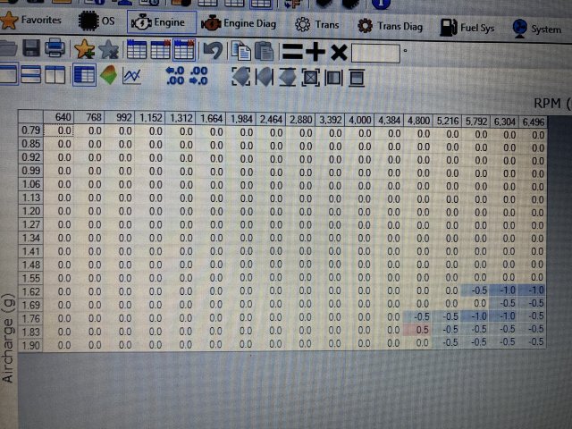

I just adjusted the next tune I’ll run on by this amount
So looks like this now, that is the areas STKR was blipping up in the 1/4 pull log.

That was scaled way wrong for a 2.85. You’ll see 1.7 with a 2.85. That’s your stock timing scale

How’s this look? I took everything under 1.5 aircharge and copied it over into the appropriate rows
