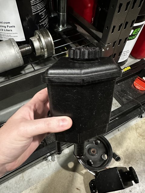

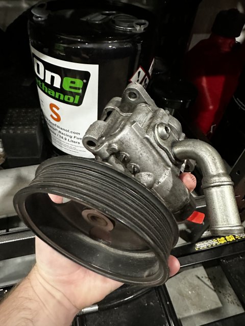

Here’s one solution. This pump is for sale as well (2015 challenger hellcat pump with fitting for remote tank)

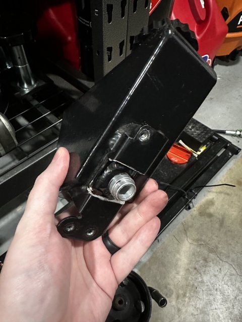

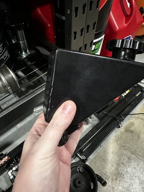

I also have a metal tank from a whipple 4.5 that bolts to the top of the stock pump, you reuse the mounting bracket from stock pump/plastic tank. just needs an o ring (I have some laying around)

Also have a remote tank for sale:
View attachment 113395 View attachment 113396
The reservoir cap on the metal tank needs to be relocated to the other side for that to fit.
Good to know!
#79
Then da lines are ass backards.
