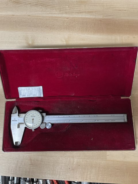

If you don't have a set of these, you'll want to get some.
I'm old school so I prefer the dial version to the digital version. You'll find plenty of uses for them. Cars, guns.......
These also measure mm......if that matters to you. Sometimes you need that.
https://www.amazon.com/Mitutoyo-505-742-Caliper-Range-Accuracy/dp/B0142HWYIW

Ya. If I get one it’ll prolly be the husky Home Depot brand haha
Yep, but you get what you pay for. If you take care of these you will have them forever. Mine are easily 25 yrs old and they were around that much money back then, but they were a certified set that came with a calibration cert. I got a deal on them through my work at the time. One of the good things about the dial ones is that you don't have to worry about batteries going dead, or leaking and ruining your tool.
Well worth the money.
What you also have to watch out for are smoe of the less expensive ones only measure "outside" dimensions. They don't have the ability to also measure "inside" , depth and step.
I have used all of those functions over the years, so I have gotten my moneys worth out of them.

Every racer needs one. Have had this one for decades. Don’t use it much for automotive anymore but still seem to need it fairly regularly. image.jpg
Every racer needs one. Have had this one for decades. Don’t use it much for automotive anymore but still seem to need it fairly regularly. View attachment 57238
Yep.....I use mine more for gun things now, but they gave me the ability to do what I needed each time I needed them.
