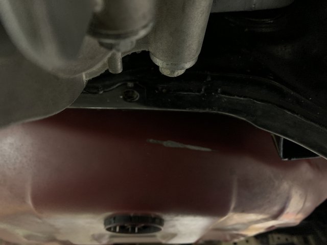

Has anyone inspected their trunk by their subframe? I have definitely had some movement there and have hit the underneath of the trunk
with what? What was hitting?

so what do you think hit the trunk? There is a gap
