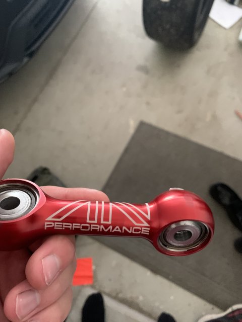

I still can’t believe I paid this much for a sway bar link. But you pay get what you pay for. Much much better design for the 15in conversion.
What makes it better?
4,385
10,911
Thread Starter #785
It hooks to the back of the toe arm giving more room for the 15 in wheel.

AAD parts are top notch. Parker doesn't cut corners.

Those Spheriflex Bushings are the shit, I see he put them on both sides. Nice piece Jon!
