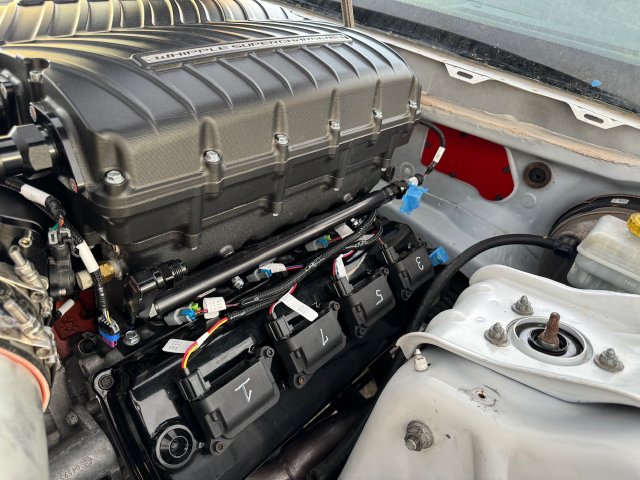

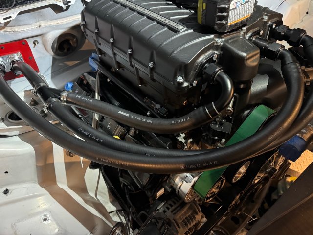

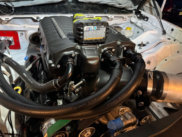

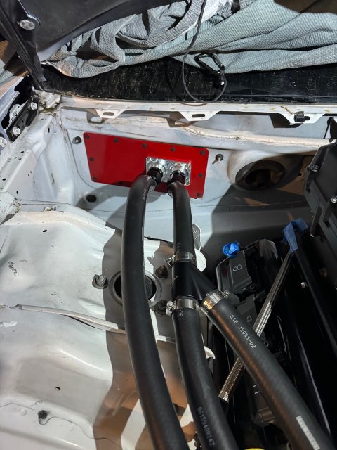

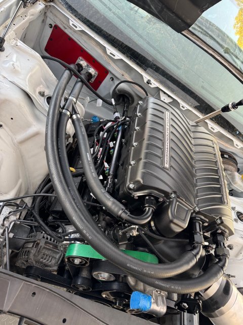

coolant lines run. Ill make a full video in daylight.

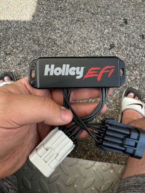

Holley stuff is in. Need to figure out a MAT sensor.
In this photo you can see the MAT sensor is right against the TPS, there is no way to get a sensor on there. I have an IAT sensor in the intake that could work but I'd rather not take the temp reading from there.

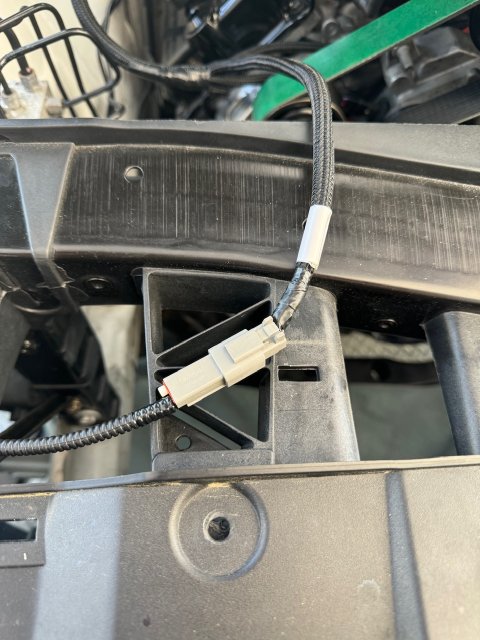

Sitting here trying to finger fuck dodge connectors and I had enough of the bullshit on the harness. Snip, snip, snip. Crimp, crimp, crimp.
MMX harness adapted to Holley EFI on the MAT PIGTAIL.
For now I am making use of the stock map sensors. 😎

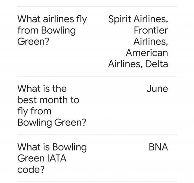

Don't know how accurate this is.

Not accurate at all.
There's DC to Bowling Green flights.

BNA is Nashville. Not Bowling Green.
Tricky fuckers. I kept getting switched. Not finding anything.
