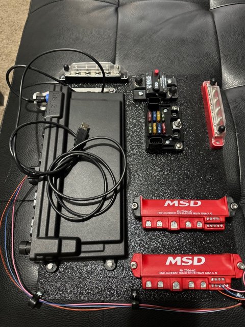

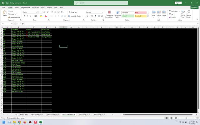

Started the wiring process. Watched a lot of videos on organization of ins/outs. Have a good grasp on it. Didn’t realize it but I bought ALL the connector harnesses… welp time to wire in ALL the sensors… lol. Now to figure out a good place to mount this. I have an idea or two. 😁

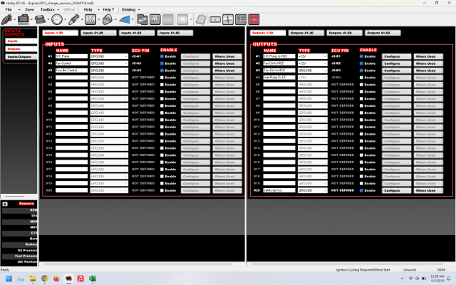

Added the motion raceworks operator postion sensor as an input on the harness. Now I know what gear I'm in based on voltage. This is a piece of kit that should be a must have. Eliminates transbrake, line lock, bump buttons from activating if not in right gear.
