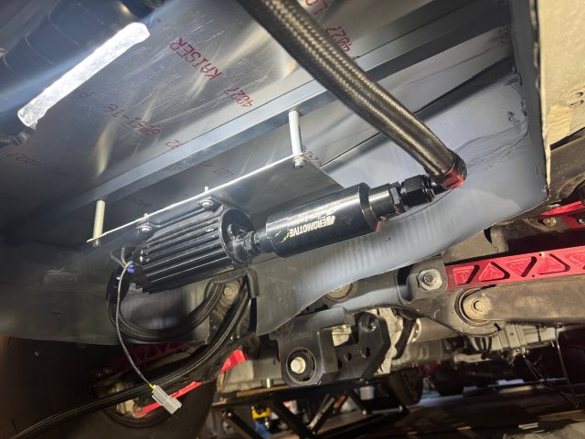

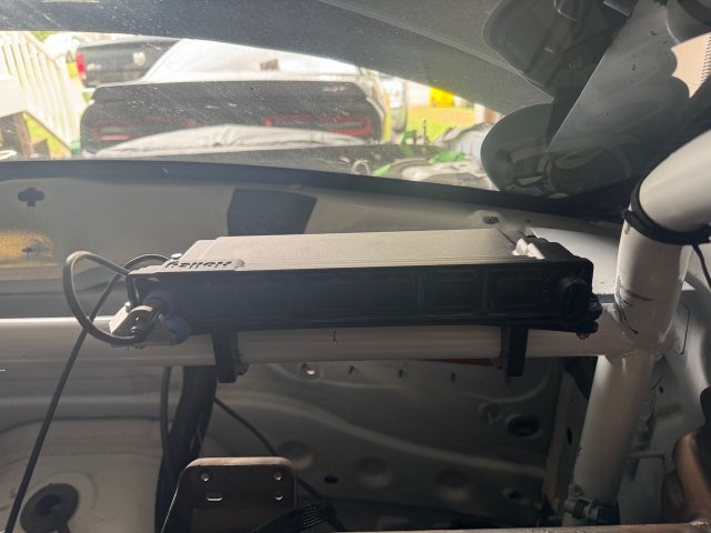

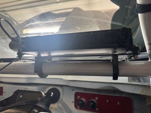

holley mounted using motion raceworks kit. Way better than what I was doing.
very happy with how this turned out, need to route return line and electric but we chooching!

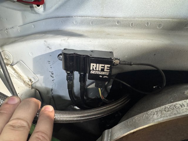

Been on a wiring blitz, fixing a lot I hated the first go around. The RIFE sensor was mounted on the TH400 and was a nightmare to get to.
now its mounted securely here. Used the existing lines and it can be serviced now. Also got one more harness out of the engine bay.

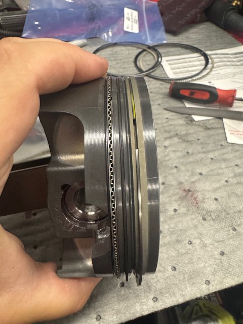

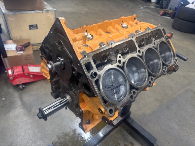

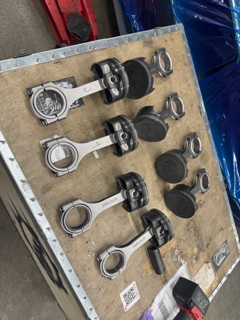

Still on wiring blitz its going well. Ill take final photos soon. However shot got real…
all bearing clearances are done and accounted for, final assembly is next! Reason I need to get engine done.
turbo is fucking heavy… 🤣

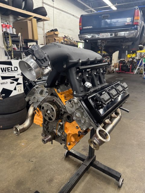

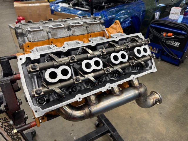

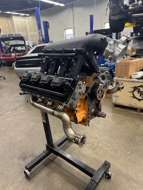

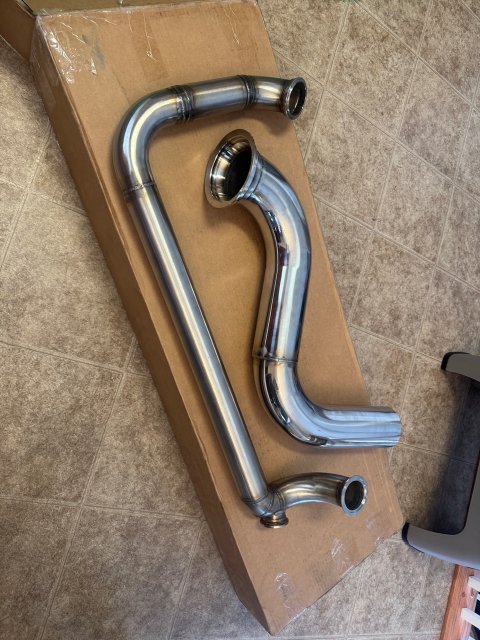

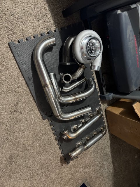

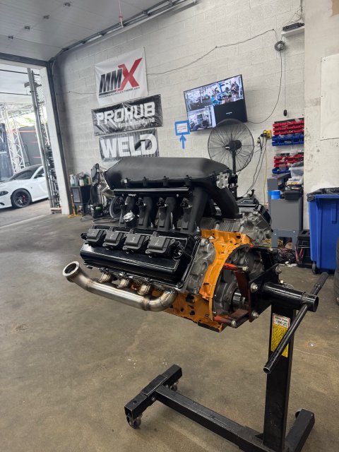

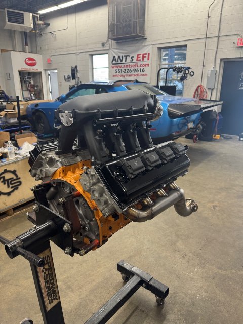

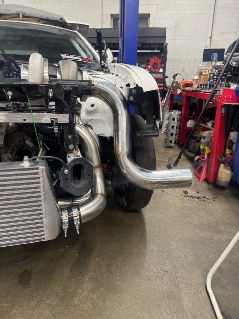

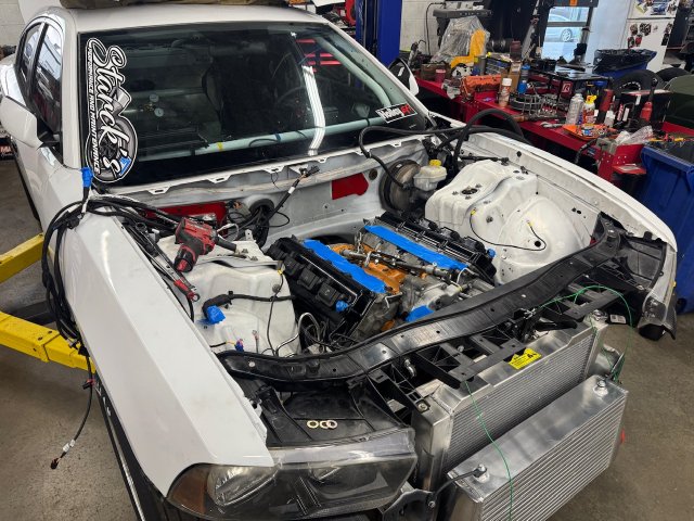

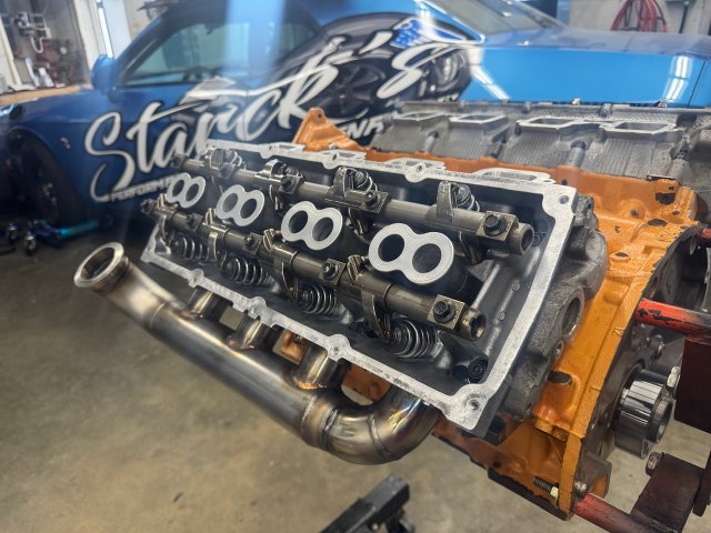

Mega post! 99% of the kit is here, ran into a small snafu with one missing component out of my boxes. That’s why the front timing isn't finished. Didn’t stop me from having fun! Enjoy the photo dump!
IMG_6859.jpeg IMG_6853.jpeg IMG_6854.jpeg IMG_6865.jpeg IMG_6866.jpeg IMG_6869.jpeg IMG_6870.jpeg IMG_6871.jpeg IMG_6872.jpeg IMG_6848.jpeg
8,745
7,679
Amazing! Who makes those turbo headers? Looks like they would clear the ac compressor and the alternator (not that you’ll have an ac compressor)
Mike Walker from Walker Induction, grass roots small business fabricator. I do have an ac compressor. Im not interested in running a water box 😉 (but this is down the road)

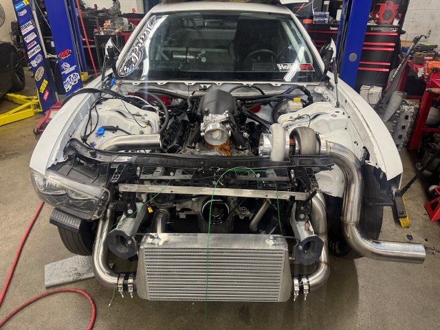

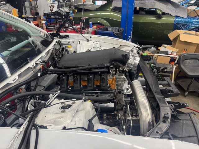

Thread Starter #752

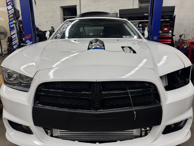

Started at 8am.
pic taken at 1030, mounting intake then will figure out where to cut hood
8,745
7,679
That intercooler core is THICK

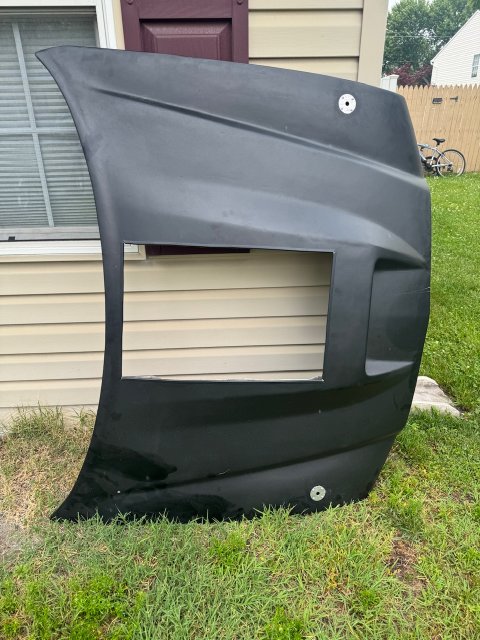

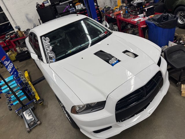

Thread Starter #754
MMissile
#19101
5,617
22,326
Macomb County
2023 Challenger Hellcat WB
What's the hood look like?
19,115
100,367
Looks serious.
4,130
10,402

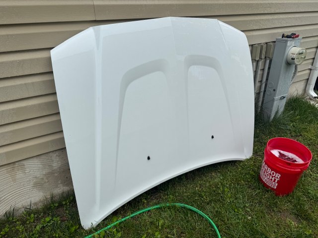

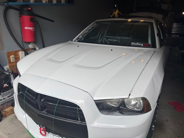

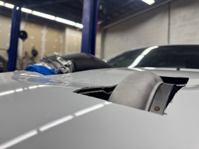

Thread Starter #758
I did my god damn hardest to not hack it up.

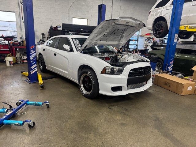

still need to debur and cut the fender exit.

You gonna use another hood? Use yours for a mold, after adding a couple blisters? Everything looks great.
4,130
10,402
Thread Starter #760
Nope. That hooks on there and thats it. Im tired of breathing in aluminum.
