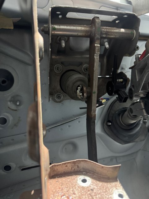

Absolutely abysmal, trying to reuse the booster/mastercylinder with new brake lines. Dodge has proprietary bullshit connections and not normal brake flares. So I get to replace the entire master cylinder now. If @zhc or @Marc W know the bore size behind the booster please let me know before I order something. I'm doing the Summit racing brand to save money, just need to know the bore size to order the right one.

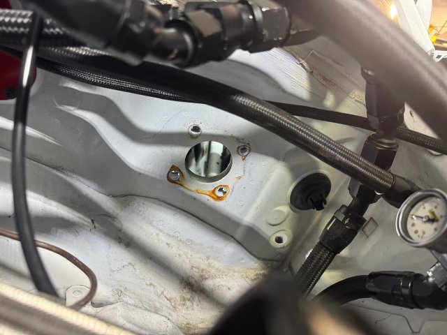

Bore size doesn't matter, will need a custom mounting plate.
Ordering a strange kit and will fab up a plate.

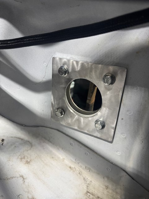

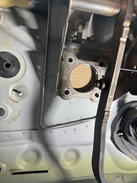

Custom master cylinder plate.

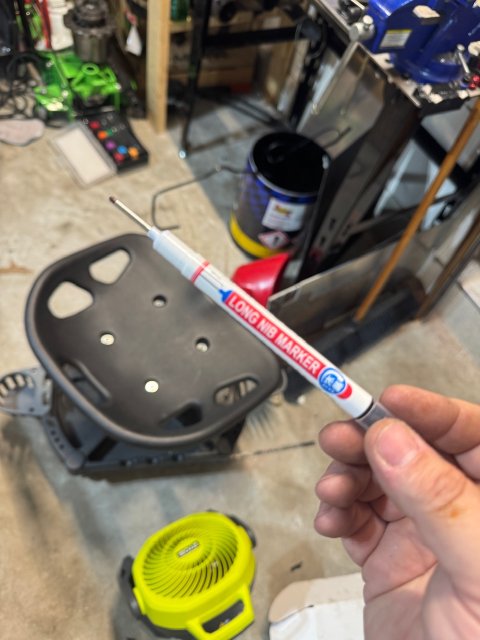

the nib marker was a hot tip given to me by a local fabricator
