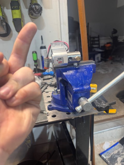

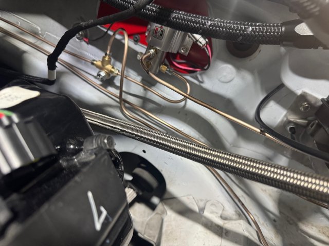

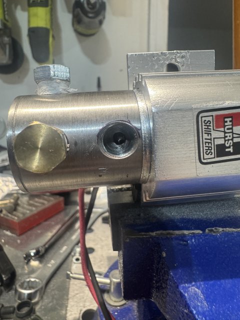

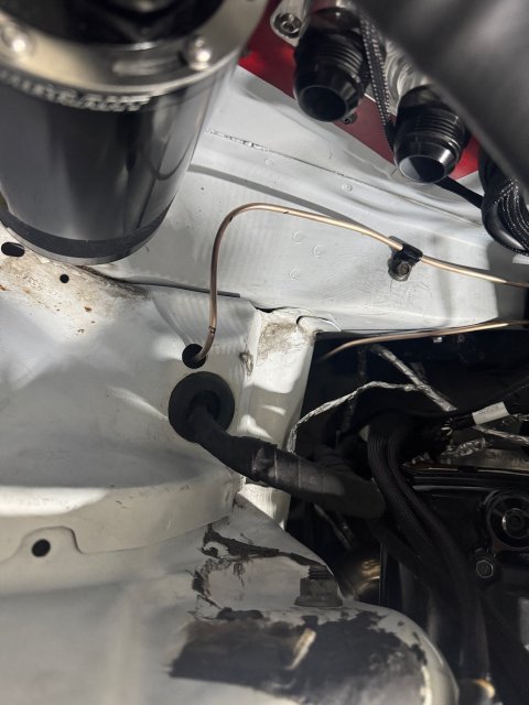

Im losing my fucking sanity, cant get this shit to seal.
sure enough the fucking hemi line lock is not inverted flare…
starting to lose my sanity and mental health

Is that teflon tape?
I use Loctite 567 for anything that's going to have pressure or fluids behind it. (Nitrous, oil, brake, etc.) The only time I use Teflon tape is on my wife's gardening equipment.

Though I see that’s not what you’re struggling with since a flare fitting should seal without any sealant.

Pulled the threads on the line lock. Im done. Burnouts will be done old school way.

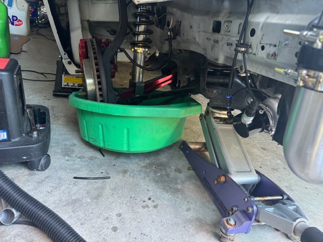

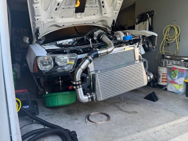

Car slid off quick jack. Im kinda fucking done at this point. Im getting front brakes finished. Rolling it into the street and then dragging it to side of house where it will sit for a year.
Passenger wheel now sits at 2 o’clock instead of 12. Probably means suspension was damaged.

That’s horrible man, i feel for you with all the road blocks you’ve been running into. How did it slip off the quick jack? Have me worried about leaving my car up on mine

I will never leave the car suspended again. It comes down if Im leaving the house or done working. Have no clue as to why it failed, no leaks.

Was it backed up to the arm that’s supposed to lock it in that spot? Min always goes down a little, I only use it with it lowered on the arms because I don’t trust the lines

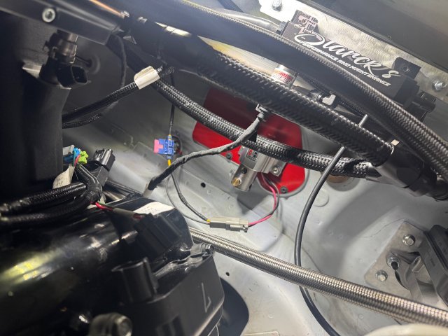

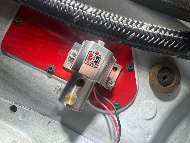

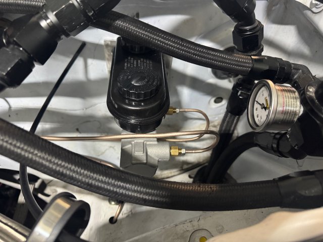

No leaks first try, also improvised parking brake.

Ever figure out why the quickjack had issues?

Both driver side and passenger side have been having issues where the metal release is not flipping back to allow the metal tag to catch. It may have been where drivers side flipped and passenger did not and over the course of the day it just lost pressure.

Interesting, I was thinking of getting some and the videos I've been watching all claim safer than jack stands.
