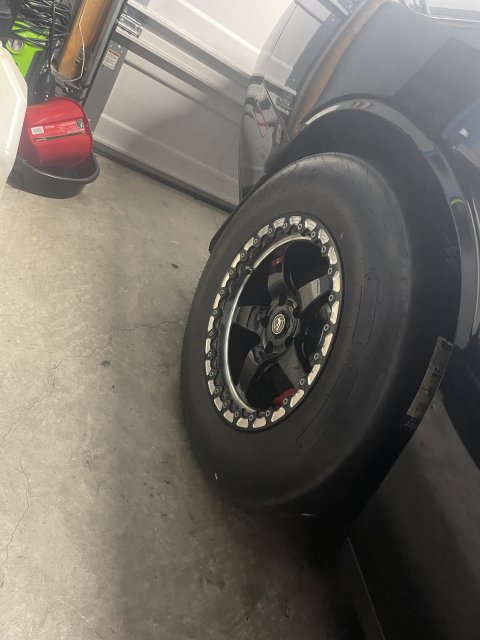

Big bishes on, she #thicc, happy to report longer studs and spacer doing their thing.
F4894513-9DE9-42E9-B91D-90FFDD4A35E3.jpeg 7A0E1C3F-D04E-401F-9683-FFCA636FDF8D.jpeg
Yepper,, all my flea on says had to have the longer studs.Youz know kinda like a snow stud not a run flat like in Tennessee. Soz, I brought em all down here with me. Kina like a condon mation.

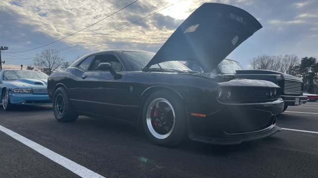

On the last run the car was getting hot, lots of issues in the staging lanes but it was like a freight train rolling down the track. None of the weather matches from last year so this is a hell of an improvement. Comparing the data from last season it is as follows:
[email protected], DA: -842, Humidity: 51.00%, Temperature: 48*F.
The car is loving these injectors, I'm loving feeling competent enough to go in there and tweak. My review of the DBR's is still pending. Learned they behave more like a slick than a radial even though they have a radial compound. Also don't go below 18PSI otherwise they really behave like a slick. Was getting a little "jut" in the ass on the 1/8th cause they were spinning so fast they were folding over. Puckering moment for sure.
Plan to chop up and fabbricobble a video for sure. Since it was opening day the media guys there were all over my car cause with these big ass tires, skinnies up front, some top choice photos are incoming and will put a video out soon.

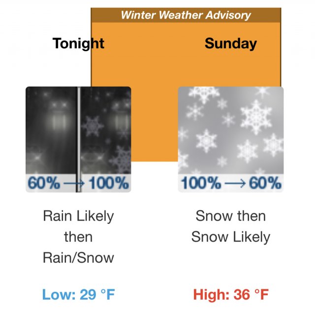

I'm more shocked you don't have snow on the ground in Maryland. We have lots and 20 degree highs right now
You keep that bad juju over there. Tonights forecast.🙃

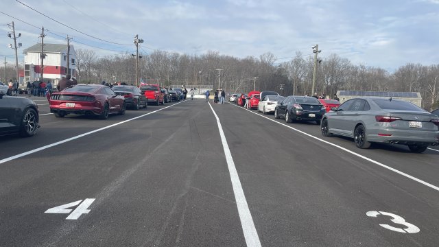

@fumanchu182 so was yesterday a planned day to race? I looked on their site schedule and it shows March 5th as 1st day
4,130
10,402
Thread Starter #476
They decided on Monday to prep for the good weather. It was really a big turnout too, spoke with the owners and they said they wanted to do a soft launch to work out the new system.

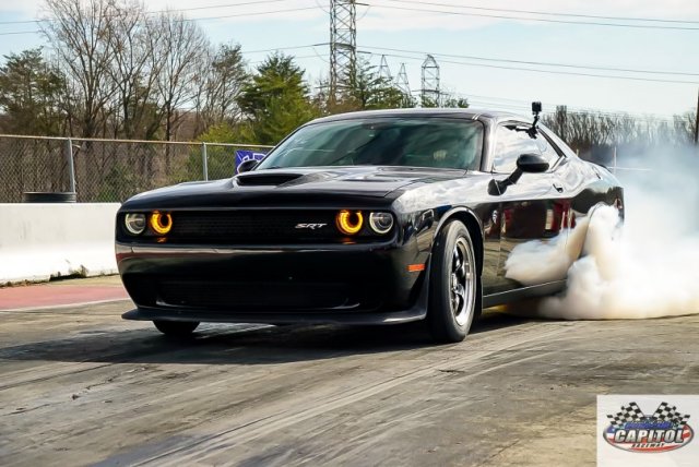

Track photographer went in!
87B08220-C772-4D28-9297-CF05E9459CF9.jpeg EA73778B-4044-4739-B855-1D7DC17457DC.jpeg
