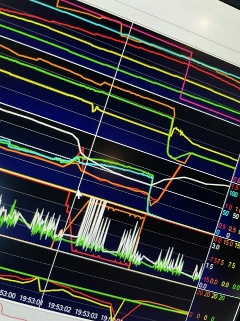

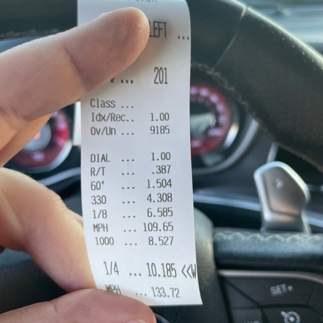

The good: set a new personal best. The bad: boost a pump is probably on its way out. The ugly: hit limp mode in fifth in the traps... Anyway still on 93 octane and locked into 10 deg of timing till I get a full race gas tune. OstDyno worked their magic with the TCM. Car was loving it.
Not too shabby eh?
white line dipping down is PSI. Went from 91 to 51... the below that all sorts of fucking knock as a result. 9B57A3FE-B454-4995-A4D0-D26284D9A4F0.jpeg
But it still hauled ass! Have a ton of good passes on video I’ll edit tomorrow. Logs are off to the tuner and I look forward to resolving those issues. Might need a better fuel setup? Might need to refresh the trans, who knows...

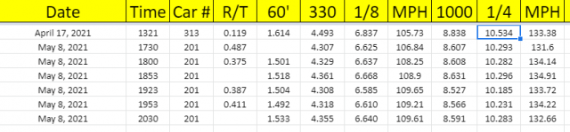

Here's all the data from the races that day. Left a day in from the 17th so people can see how much faster the car is moving. This is due to a TCM tune being tested. If anyone modifies a hellcat and doesnt get a TCM tune done they are doing themselves a disservice.

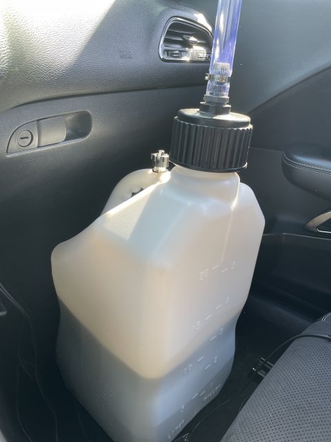

Driving around w that gas container in the car?
4,130
10,402
Thread Starter #116
Only to the track and back. Never when in and out of town. No where else to put it. Don’t trust it in the trunk (nor does it fit). 🤷🏻‍♂️

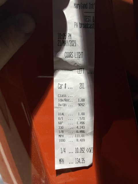

She was booking tonight. Was running N/T testing. Still on 93 with 10* of timing. Great news though, no knock at all! Time for that race gas tune... 😈
62,205
217,350
looks like the DA was pretty good around 200
4,130
10,402
Thread Starter #119
DA was good. When I ran that time, the humidity was around 58% and the grains size were 56. The cooler air and DA for sure helped. Will have a quick video up this weekend. It was a lot of Hellcat on Hellcat crime last night. 🤣
6,410
41,525
WTG that's a nice Timeslip!
