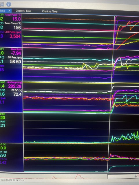

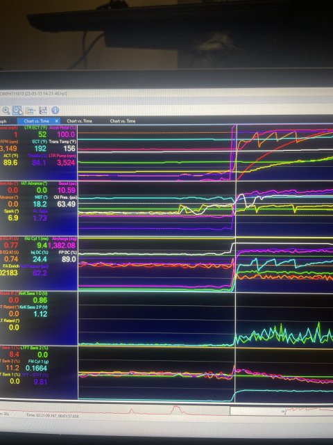

I'm excited for this, here is some math about how slow my launches are. Reaction Time = Vehicle Reaction Time + Driver Reaction Time.
70647547511__AD02E995-11C8-4B0B-BF68-3F88EB71C317.jpeg 70647552957__284EF4D9-AE3A-4A2E-892F-BE1F8FFDC539.jpeg
.658-.118=.540 before the car even moves, dodge etc sucks doo doo
Does the lag time stay consistent? I'm going to say no from my experiences.
4,048
10,118
Thread Starter #1,505

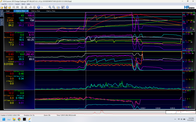

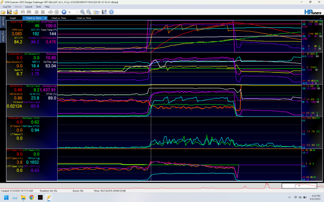

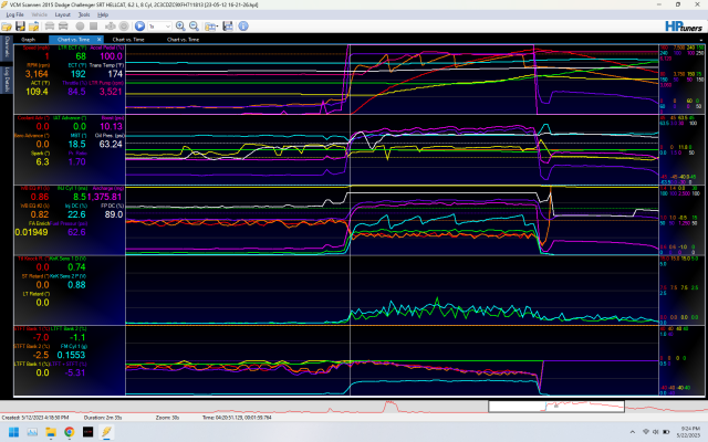

All experiences are different. Reviewed a small sample of my logs.
Three different logs, that gap exists in all three of them. I'm sure I can go back and look at older logs but I'm pretty sure this is consistent.
It always seemed to me that the amount of time would vary. Stay fairly consistent but really lag other times.
But it could of just been me moving slower than usual.

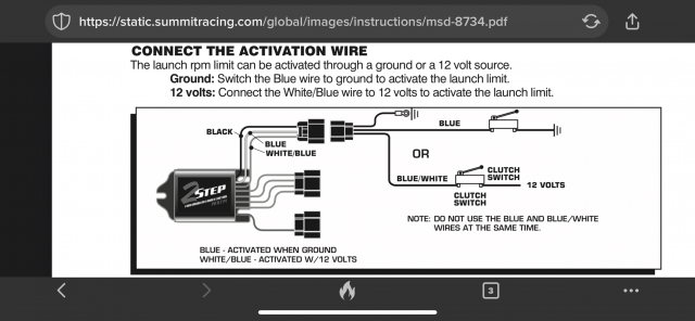

I went up to Stage 6 a couple of years when I was looking for a reaction time solution and asked if they could convert their 2 step over to a button release.
They adamantly said no. Can it be converted to a button release?
Not sure what you mean? My two step using a stage 6 / msd box is activated with a button I hold to activate it.
I guess that it's changed since I went there. They only offered a brake pedal setup.

It’s just a monetary switch, no reason you can’t convert it to a button
That's what I thought but they were adamant about it couldn't be modified, at the time. I guess they didn't want to work on my car?

ship the car to me I’ll install it off a button. So long story short:
Button on steering wheel is just fine however you still have to let go of the brake, as hellcats don’t have transbrakes from the factory. Mine will remain on the brake. Actually doing a part 2 where I wire in LEDs to let me know its active.
