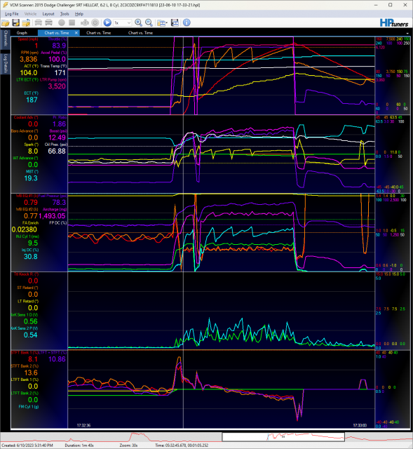

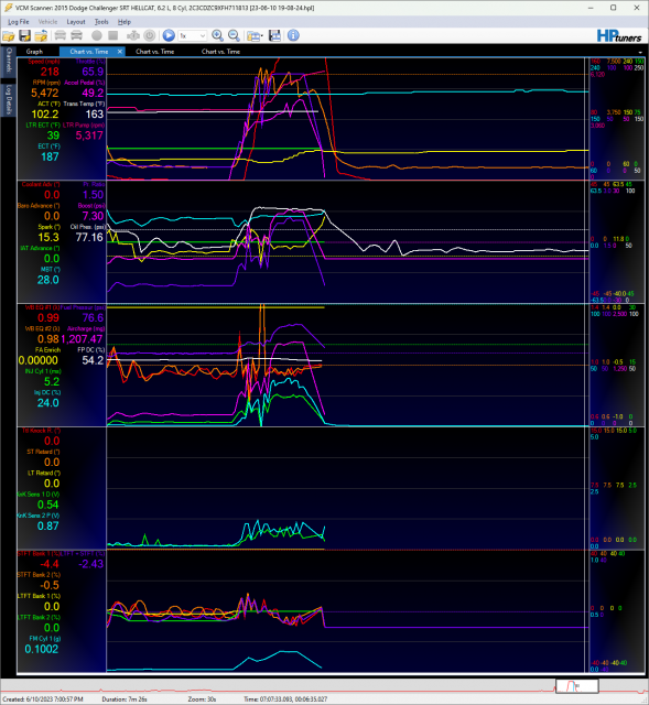

Attaching two logs just so you can see what the two step is like. One of the things that has me most excited is that the throttle is open and the cold air is coming in and the IAT's are dropping. God bless the IC Chiller. Compared to power braking the car gets hot quicker.

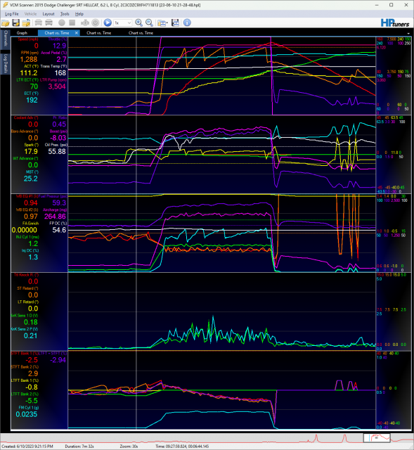

The experiment is over. Two step is for sale. Car leaves on way too much boost. Blew the tires off every time. Will include harness, led lights, foot switch assembly and bracket and 2-step box.

Really? It shouldn’t be leaving with any boost - did you enable torque reserve in the tune? What’s the lowest rpm you can set it at? 2k? The bypass should be open even though you’re on the 2 step I would have thought

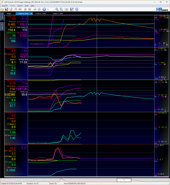

^ Track couldn't take the hit, was leaving on 12PSI. Spun like a mf'er 10.xx @ 14X mph
^ Too high of a burnout and banged off eight at 218mph. Transmission through a U0402 implausible data. This was my fault forgot to put the paddle shifter on when doing a burnout. Car was not happy.
^ left so damn hard It banged off second gear four times before it went into limp mode. 68xx, 68xx, 66xx, 66xx. Not a good situation. Decided fuck this 2-step.
^ Power braking 1200RPM, little bit of wheel spin 9.6 and car felt solid.
I am leaving the 2-step on. However I am putting a hard switch on it and will leave it off till @Jon-MooredPerformanceLLC and I have a chance to sit down and figure out a strategy for it. I also am not refreshing the ET Street Radial Pros once the are burned through. These radials are very prep dependent. I am going back to a DBR as they seem to love any type of prep. I am also removing the Sportsman S/R up front. Too damn heavy. I will be moving to the Hoosier bias ply 28x4.5-18. I could get away with driving the Mickey T's for small trips, I will not entertain that on the Hoosiers. I have my setups for street ready to go. Welds all around with ET Street R's. Not for speed, just cruising around.
I'm leaving on 12PSI of boost in one of these passes and it's just nutters but if I compare it to the power braking when I start to move I'm on 8psi. I don't think 4psi is that much of a difference but then I look at Cleetus mcfarland. He's leaving on 12PSI but has a hell of a suspension setup to make it work. I don't want to change the suspension. Diff, axles and driveshaft are all in working condition thank you Jesus!
When you are using a 2-step all it does is interrupt the ignition setting. It doesn't not interfere with the throttle or bypass at all. When your foot is on the accelerator to the floor the throttle is wide open and the bypass is closed to make maximum boost. That's just how it works on our cars.

that’s good news about driveline being intact. I do think some things can be adjusted in the tune at launch that would be the 2step more feasible. Interesting about the pros, what psi did you have in them? I have ran my text street rs down to 15. Prep is always a factor. M6 cars like a bias ply to blunt dumping the clutch, autos like a stiffer radial. You could have been making an extra what, 20hp with each lb of boost? So from 8-12, that could be a pretty big difference. Could try pulling some timing out to compensate for the higher boost
I guess I’m thinking more of how the factory launch control does it then, I was always under the impression you could not build boost without using torque reserve on the line to close the bypass and allow it to build boost

Will probably have to fiddle with the torque reserve feature. It's torque based and cracks the bypass open to achieve desired launch torque. I played with it a little but never had any luck with it and gave up but admittedly didn't put much effort in.

We may have to open that bypass a little for you
