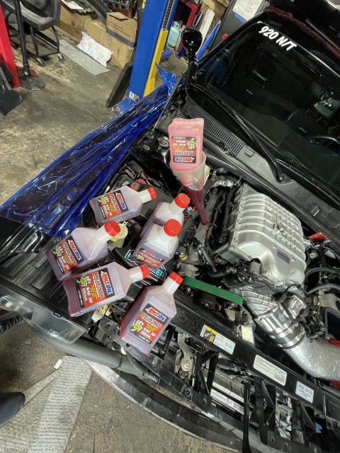

In other news have an appointment early Thursday morning. We are going to attempt the break in procedure again, without a lot of idling and what not.

What for oil you have in it?

Was asking about your oil pan issue.
Ahhhh, yes, I remember the picture, this may be even the second time I’m asking lol. Sorry about that if that’s the case. Just making sure you used a break in oil not a full synthetic oil.
if you have glazed the cylinders due to improper break in the only way to break through that stuff is to run a ball hone in it and hone it off which means you would have to drop the Pistons out. I have seen an old trick of using a powdered cleanser work to remove such glaze but not in a car with a supercharger. If it was a final last ditch effort for an engine that was destined to come out Anyways, I would be tempted to give that a try but damn that’s extreme. Total Seal makes s product called Quick Seat that is a super fine abrasive used for first start break in but it needs to be applied by hand to the cylinder walls before putting the pistons in, but it’s a similar concept to using a cleanser in a running engine. I wish there was something we could do to help you out of this pickle. Tough to watch a fellow hellcat brother in pain and feel helpless to help.
