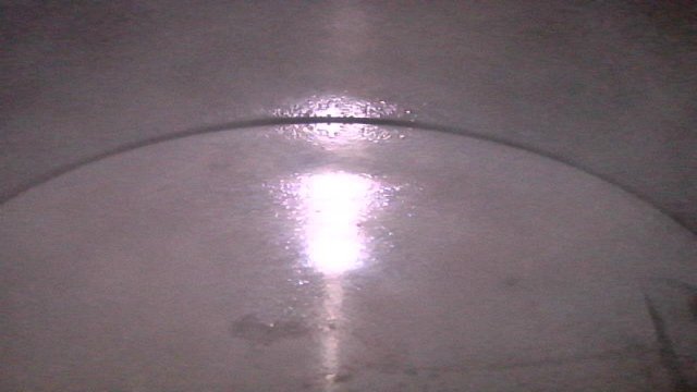

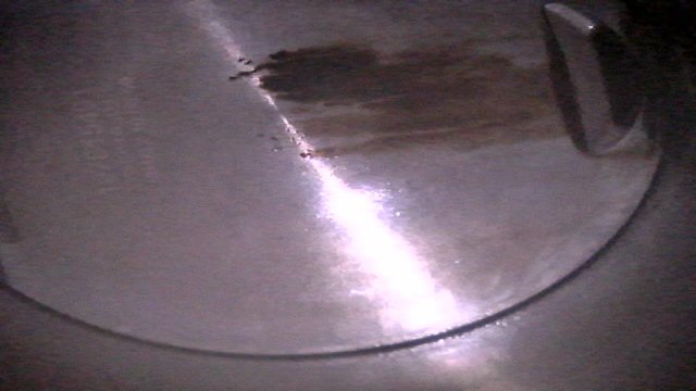

Cylinders 2,4,6,8 no longer have pools of oil on them. IMG_8068.jpeg IMG_8071.jpeg IMG_8076.jpeg IMG_8081.jpeg
#2 still has some cleanup to do but with time…

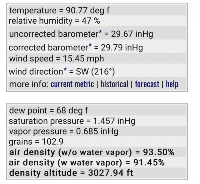

In 3000 DA made about 21psi of boost and almost shit myself.

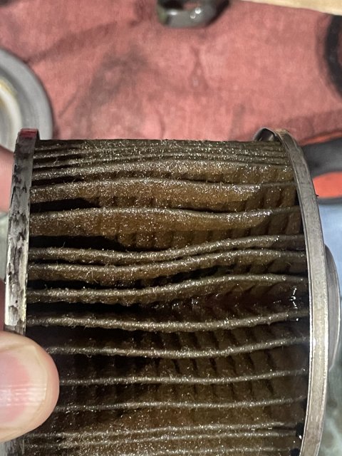

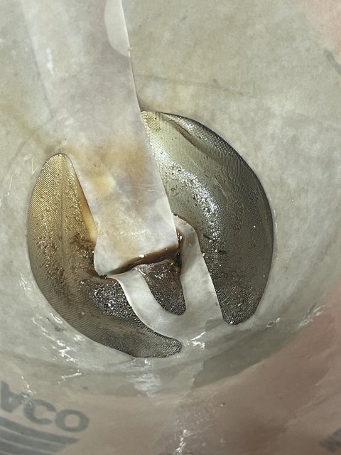

Also we cracked open the oil filter and we also ran the break in oil through a filter
for break in oil this is expected.
Are they flakes or reflections?

Cylinders 2,4,6,8 no longer have pools of oil on them. View attachment 110272 View attachment 110273 View attachment 110274 View attachment 110275
Both this is expected also little pieces of rtv from the front seal as you install the timing cover on a new motor
