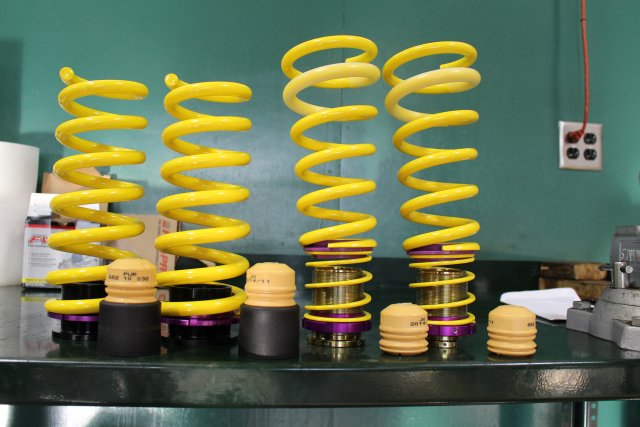

I went with KW adjustable springs and over 30K miles later still real happy with them. I like you can dial them in to the height that suits your fancy. Dropped mine a fuzz over an inch. I did go through CV boot tear problems until I swapped out for Redeye half shafts. So far, so good. Ride is similar to stock but does corner much better. Also will not affect any of the adjustable suspension options. Just have to remember your stock shock travel will be reduced somewhat. I also installed a Bwoody kit, in back, to get the neg. camber dialed back in to spec. Camber bushings will work for a little less money though.
I do a hybrid with the KW’s. Have the KW’s up front at about stock height, but they are superior in their specs up front. Retained the OEM springs in the rear because the OEM is stiffer in the rear and I don’t want to lower it. I like it. After several years the darn fronts need tweaked once in a while because they want to drop a bit. Just glad I can keep doing it.

Revitalizing this old thread because I have questions for MiMiHemi's old post #9:
1. Now KW has 103 model specific part numbers of this product, each of them designed for German vehicles so I cannot select one for my '23 Hellcat. What part number did you order for your ride? How heavy is your SRT 426 (assuming you installed the HAS on her)?
2. You mentioned you did struggle with the drive axle boot tear until you replaced the axles for the RE version. Earlier I was exclusively using KW V2 coilovers on my TA392 and had never seen this problem with the ~0.75-1.5" lowering range (though the rear coilovers are not real coilovers, the springs are sitting in their cups and I assume the same setup for these HAS ones). What do you think for the root cause of the boot tearing after installing the KW HAS in the rear?

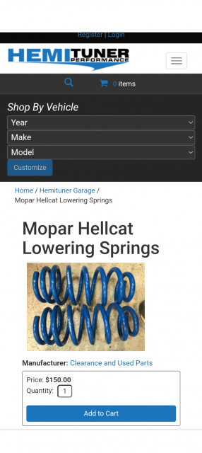

Hunter are you sure those are for at least an SRT? I know there is a set that is for early LX non-SRT models. I am also suspect at that price. Their website delivers 2005 for the year on that set.
9,924
27,422
I was searching for hellcat lowering springs.
But, I was suspicious of the low price also.
