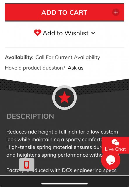

They may be the correct units, but I do not think he has any….
8,549
52,628
I got someone on it. If Mopar has any he will sell them to me. Or he will tell me what to buy. I’ll report back.

I just got the opinion from what I consider to be a great source. He confirmed the Mopar Performance springs are discontinued. He recommends the Eibach Pro’s. I will expect better handling maybe, but traction?, ride?. I don’t think the ride will be much different.
Eibach Pro are the ones I will be ordering.
