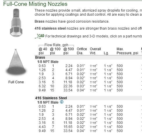

Is the tip of the nozzle like a shower head or just 1 hole? That’s where it’ll turn into a mist vs a stream of meth.
Don't remember been awhile

These worked great for me for years and have a filter screen. McMaster Carr.
14,755
45,297
