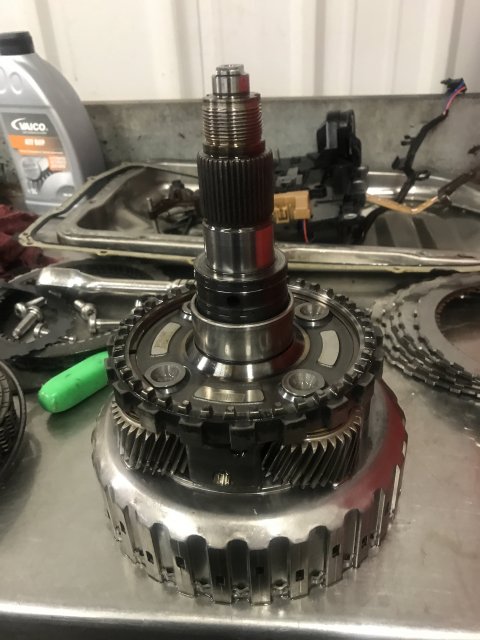

Thread Starter #366
Here’s a pic of the output shaft , imagine people are breaking these , what I want to know is did it break on the launch or on the shift AD9CF93E-4327-44BD-8A1F-417F2B165D6C.jpeg
Here’s a pic of the output shaft , imagine people are breaking these , what I want to know is did it break on the launch or on the shift View attachment 7866
Where is it breaking? What part of te shaft ?

Thread Starter #368
I HAVENT SEEN IT I ONLY HEARD FROM CURT THAT THEY HAVE BROKEN IF YOU SEE WHERE IT BREAKS YOU COULD POSSIBLY ADDRESS THE WEAKNESS BUT OF COURSE TURNING THE PRESSURE UP BREAKS PARTS AS WELL
3,371
5,926
Thread Starter #369
TO REPLICATE THAT P4 PLANATARY WITH A STRONGER ONE I WOULD THINK THE COST WOULD BE A BIG FACTOR IT ISNT JUST THE OUT PUT SHAFT LIKE A GM OR FORD
