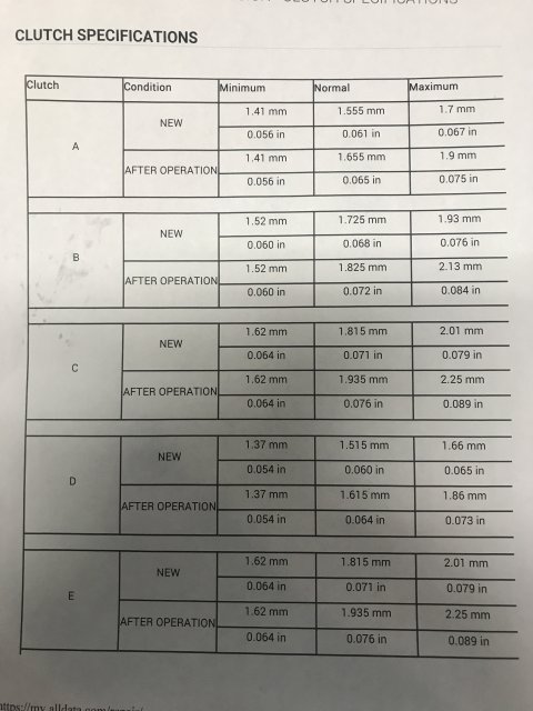

Here’s stock clutch pack clearances
I checked the e clutch in mine right now and it measures 110in as you can see the after run in should be a maximum of 89 makes you wonder how close ZF ACTUALLY CHECKS THEM BECAUSE TGERE ISNT ANY CLUTCH MATERIAL MISSING IN MINE TEY WERE JUST GLAZED OVER 🤔
I thought German engineering was supposed to be superior.:rolleyes: Oh well I guess factory clearances are factory clearances. (FU BMW crowd) .:LOL:

Apparently they were lazy the day they built mine but even with that clearance it never logged a fault code or went into limp mode
