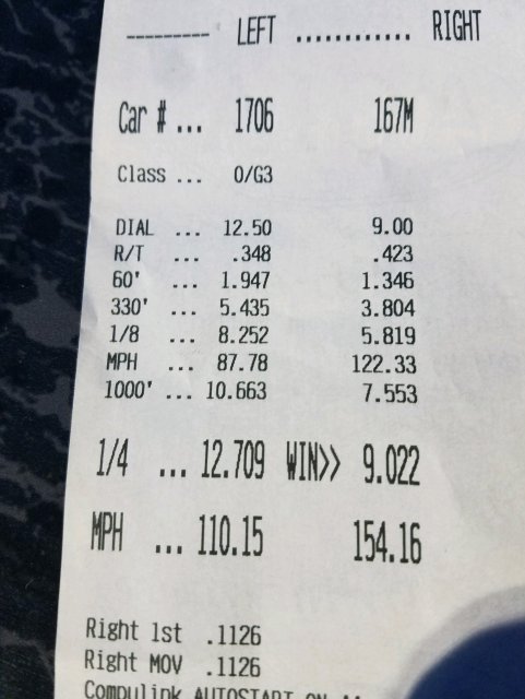

Everyone was surprised how I ran 151+ at Atco. May be tuners have figured out how to tune these tcm
BTW, there’sa Charger running 4600 lbs 9.0 on 2.4 Blower. I’ll say that’s the fastest car than anyone. Including demon redeye with that weight
