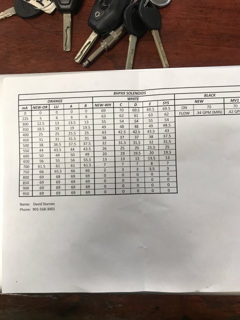

I almost forgot to share my solenoid flow test results so here you go 21FA4C73-953C-4AA8-80CC-4C28AD097815.jpeg 49724DD5-F594-49DE-98B0-36E5805779F9.jpeg
