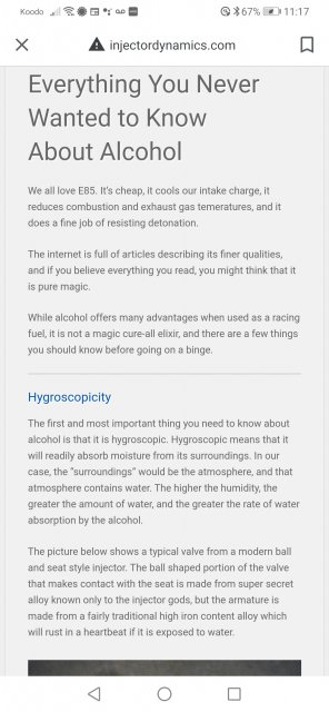

Catdodgehell from the other forum had posted quite a bit of info there. I just did a quick look and this is interesting but from Injector Dynamics. Screenshot_20210527_111728_com.google.android.googlequicksearchbox.jpg Screenshot_20210527_111736_com.google.android.googlequicksearchbox.jpg

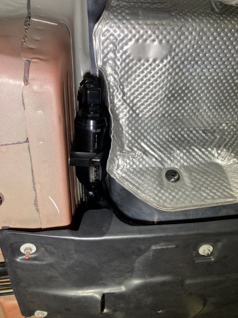

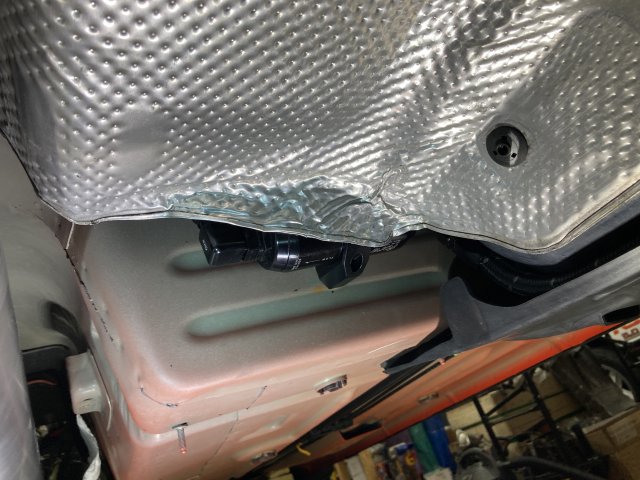

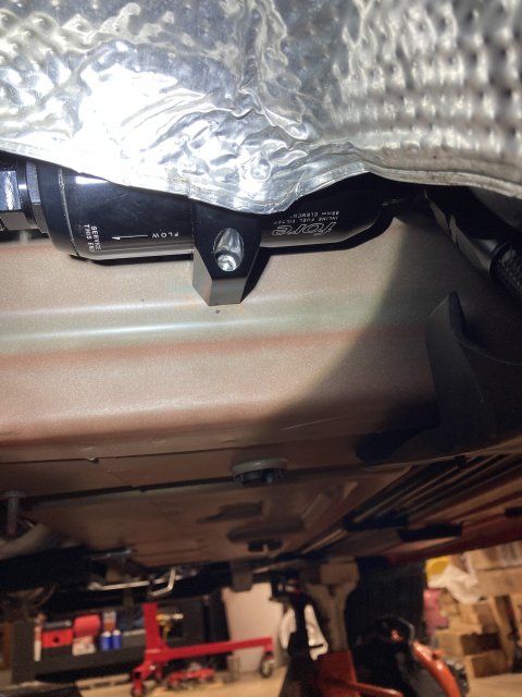

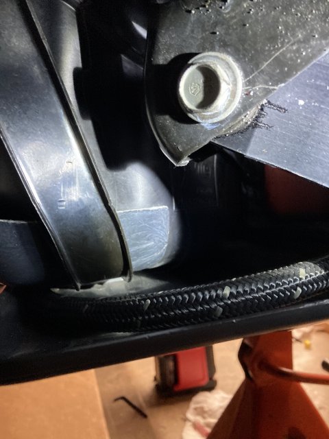

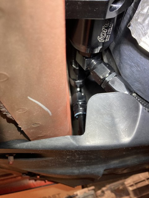

There are flexible lines but none are rubber, their that hard flexible black plastic stuff with quick couplings ends each end that couple to a stainless fuel line that runs from just under the fuel tank to about 12” from the fuel rail connector. I added the Tapped Performance E85 Fore Systems Microglass element 88mm filter unit which adds about 2ft of that special braided hose that fuel does not permeate through.
5CD57962-2491-4DB2-923E-22357A949D13.jpeg 080F8134-CA4E-447B-9068-7111C3C6E7F4.jpeg 03FA6FAC-FBCD-4E27-8211-57B4F9E09E60.jpeg FB80981A-8BDA-42DD-AED0-138D1C9C35D2.jpeg

Nice clean install. How'd you get to the top self tapper on the mounting bracket for the filter?
3,780
8,936
I didn’t use the included self tapping rust makers LOL. I used 6mm SS blind rivets and put RTV on them before setting them then painted over them. I used a dremel with a right angle head and a end cutting burr to make the holes in the body. Then fastened the mount with 2 6mm SS hex head cap screws into the threaded blind rivets. I don’t like sloppy LOL. Here you can see one, there’s no seeing the other once the heat shield was put back on. image.jpg
