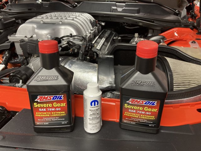

PS, I highly suggest Amsoil Severe Gear 75w90 in the Diff with 1-2 oz of friction modifier, it really is about the best you can buy for street Diffs)

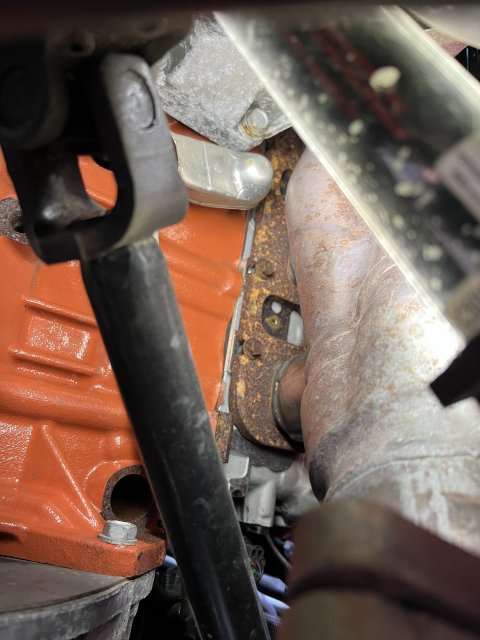

On a side note, look at the flange on this exhaust manifold. It’s like that on both sides and on the unpainted surfaces on the block. It was an East coast car but nothing else on the car is rusted. Normal or are the manifolds leaking at the gasket?

On a side note, look at the flange on this exhaust manifold. It’s like that on both sides and in the unpainted surfaces on the block. It was an East coast car but nothing else on the car is rusted. Normal or are the manifolds leaking at the gasket?
Normal rust on manifold, their 400 series stainless which will rust.
