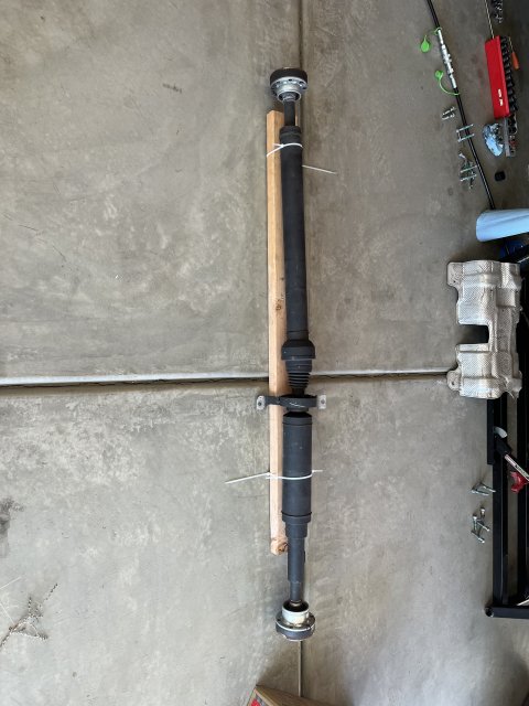

Quick tip if you’re removing the 2-piece driveshaft by yourself. Makes life way easier. Surprisingly, this is the actual technique in the factory service manual too haha, just thought it was something me and the guys used to do because we didn’t have a better tool.

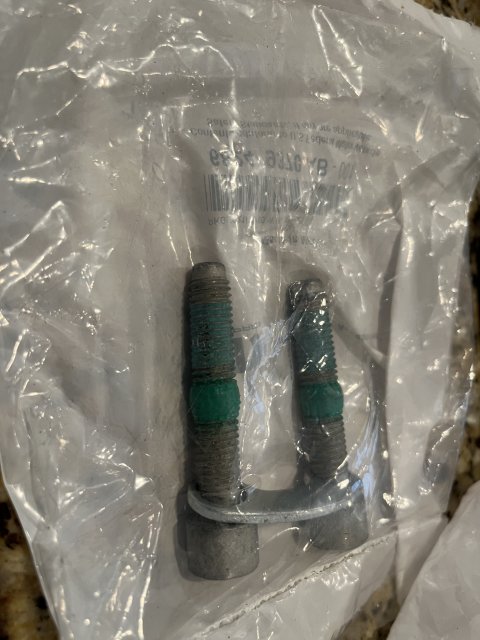

Since I was ordering a new throw out bearing and gaskets for the exhaust (connection between manifold and cats), I ordered new driveshaft bolts. The factory service manual says you should replace them but that you can reuse them if you can’t get replacements, but you have to apply lock and seal. Interesting how they have it on two different spots on the bolt and how, in the middle, it’s heavily built up. Definitely not how I would’ve applied it haha.

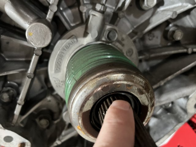

Another observation, if your car sits for a while (like over the Winter) in an environment that isn’t climate controlled, the clutch pressure plate and other metal parts inside are going to rust due to moisture buildup.
Here is a picture of the current throw out bearing. Take a look at the four asymmetric rust “dots” on the face of the bearing. That is where the bearing interfaces with the fingers on the pressure plate. My guess is that happened from sitting and not being used. Why aren’t there more rust spots on the bearing face from the other fingers of the pressure plate? I don’t know, maybe these were positioned at the low 6 o’clock position when it was stored and the moisture built up worse in that area?
All that to say, I’d probably get it up to temp and drive around the neighborhood once in while (weekly?) if you can. Honestly though, the bearing still spins freely with no resistance, so it probably doesn’t matter from a performance aspect, just from a cosmetic @BULL OCD aspect haha.

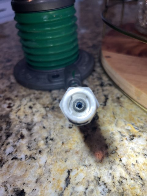

So guess I should go ahead and remove the CDV. I haven’t looked into it too much yet but I just remove the black O-ring, then remove the blue orifice behind it? Do I reinstall the O-ring?
This is a pic of the new bearing. The old bearing still has the blue orifice in it but does not have the O-ring, that’s MIA. Wonder if the previous owner thought he was doing the delete by just removing the O-ring or if it wasn’t installed at the factory where the bearing assembly was built.
@BULL you said you did this and couldn’t really tell much of a difference?

If I did, it was subtle.
