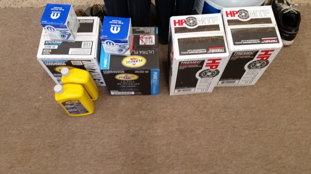

No CDV yank or skip shift bypass for me yet but I do recommend changing out the factory fluid with the TREMEC HP MTF. 20200314_100828.jpg 20200314_110719.jpg

No CDV yank or skip shift bypass for me yet but I do recommend changing out the factory fluid with the TREMEC HP MTF. View attachment 61658 View attachment 61659

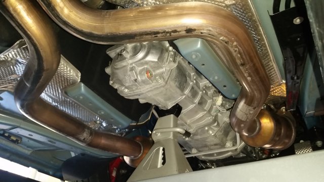

Did changing the fluid quiet down the gearbox? That was the first thing I thought about but I’m pretty sure I’m hearing the throw out bearing. Difficult to believe the throw out bearing would be bad after 4 years and 21k miles though.

The TREMEC fluid is definitely noticeable in "feel". More buttery shifts I guess you could say. Didn't notice any noise delta but mine was very quiet before.

Yeah it’s definitely the throw out bearing I’m hearing. I may just be hyper sensitive to it though and I only hear it at slow speeds when engaging/disengaging in the 1-2 shift.
It doesn’t sound bad, I can just hear it, maybe I’ll just make a piece of insulate to mount below the shifter boot when I install the Barton.

Yeah I’m going to get the car up in the air and take a look at everything (just to make sure there are no surprises) and then I’ll likely take it to the dealer and let them take a look. It still has some powertrain warranty on it, I’d assume that’d be covered.
It makes the most noise when I’m at a stop with the car in neutral and my foot off the clutch pedal. The minute I engage the clutch, the sound goes away, that’s why I’m assuming it’s a throw out bearing.

Well after popping the trunk and looking at the stock parts the seller sent with the car (which I thought was just the intake), the stock shifter is in there.
He said he had installed a Hurst shift knob, turns out he installed a complete Hurst shifter assembly.
@mopar madness hooked me up with a Barton, so I’m going to install that and see if somehow the Hurst shifter is causing more noise/vibration than it should be.
Also surprised at how cheap the factory shift boot feels, might look around for a nice aftermarket one as well.

Thanks for that info. I’m swapping it for the Barton anyways, so we’ll see. I’m 99% sure it’s the bearing though, which I’m hoping Dodge will cover under warranty.
If not, no big deal. I’ll live with it for a bit (not my daily driver) and pull the transmission when it gets warm haha.
