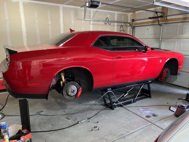

Got it up in the air today and went through it. Really happy with how this turned out, the car is in excellent shape and exactly how the seller described.
Pulled the MFERs off and a few small other things the previous owner did (tinted film on side markers, aftermarket center caps, etc.) Dropped the wheels off to get balanced and noticed a couple of the lugs are swelling.
Really happy to find the brakes are in good shape. With only 21k miles I wasn’t expecting them to be bad but you never know.
Called my local dealer to inquire about lug nuts and they wanted $16 EACH! Maybe he was confused but that was a hard pass haha.
Ordered a set of Gorilla lug nuts and Powerstop Z26s all around. Hoping swapping the pads now will increase the longevity of the rotors.

Good move on the lug nuts. When I had some PS4s put on last summer, the Discount Tire guy told me the two piece originals were prone to swelling and sold me an aftermarket set. Guess he wasn’t BS’ing.
Yeah, I had 2-3 that I could only get the socket about 1/2 of the way on. Wasn’t an issue but it definitely is worth an ounce of prevention. Imagine getting a flat tire in the middle of nowhere and not being able to get those things off.

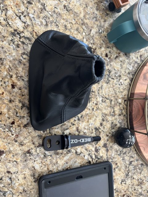

Struggling with this right now. This shift boot is not going to fit all the way over the handle and seat in that groove, not even close on mine.
What am I missing?

I stuck with the O.E. stick on mine.
A suggestion would be to soak the boot in hot water for several minutes.

Well I got the Barton installed today and I’m happy to say that the noises from the throw out bearing and transmission are significantly reduced and it now sounds normal to me.
It’s not the shifter though, the previous owner just didn’t put the rubber seal on correctly that fits into the metal plate that bolts to the floor and seals between it and the shifter assembly. My guess is it was close and eventually just worked it’s way off over time.
I didn’t do the spring mod but I’m happy with it how it is, the force going into 5th or 6th doesn’t seem overwhelming to me and rather natural. Left the shift boot off for now so I can spend a little more time driving the car and get the shifter position dialed in.
