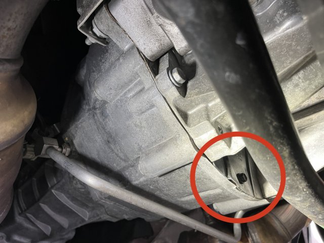

Just reached my phone under the car to snap a pic, might just be the one bolt then slides up and out. Pretty sure this will give you access to the teeth on the flywheel but I don’t remember.
4,117
10,340
It will, this is what I used for my bolt. jam a prybar in there and then yank on the flywheel bolt. Infinite wisdom before you insert new bolt in. Blow compressed air in there to clean anything out. Had to help a friend tap new threads because he just jammed a new bolt in there without cleaning it out.

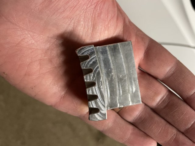

Try second gear, E Brake smashed to the floor as far as it will go, jam a wheel chick on each side of a rear wheel, a piece of 2x4 will work as well. Breaker bar with a long pipe on it. If the engine still turns try third gear, if it still turns you probably have a clutch issue. You can also try heating just the bolt head for 30 seconds with a torch so the bolt length grows but don’t let the heat hit the balancer unless your planning on replacing it with an ATI.
An impact would be great but you’ll need to get the radiator out of the way to get one in there most likely. The fly wheel locking tool is the way to go though, If I had one I would send it to you and let you borrow it but I don’t have one maybe one of these nice guys might let you borrow or rent theirs?

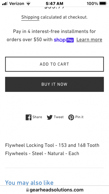

I'll try that next time under the car. Right now I'm showered and done for the day. In the meantime I found the took for 135.00, so not too bad, I guess...
You could try this flywheel locking tool for only $35

Just bought the same tool Speedy used for a really good price so if any of you guys need it I’ll have it available to you. Thanks for the help.
