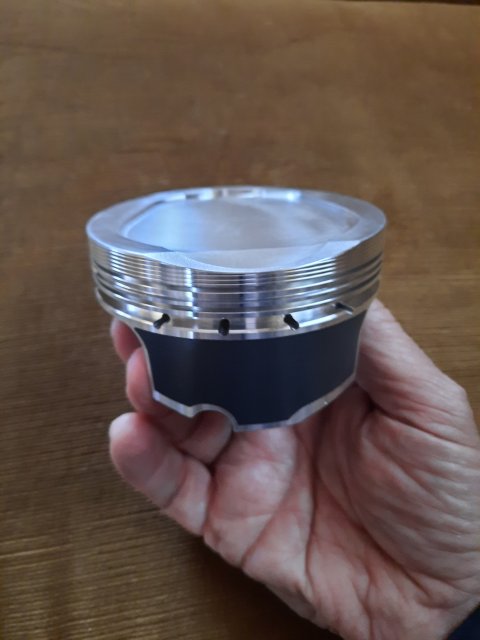

Nice!! No issues with mine, finish, weights, and fit where perfect. A custom or off the shelf offering? I paid an expedite fee to get my customs in 8 weeks but I’ve heard they where so far behind they may have stoped offering it? Post picks for sure please!! LOVE to see what you got!!
showed up today, 4.100 wiseco 9.75 to 1, molnar crank an rods, 411 stroker.
off to machine shop tomorrow.
3,313
7,800
NICE!! Same dish shape as mine. What kind of rings you going to use with them? Curious on Pin as well, Weisco supplied?
wiseco supplied total seal rings an their own brand pins, size .927 according to wiseco good up to 1500 horse. this engine will never see that much.
I just didn`t want to blow up stock config an now there`s room for a little more power.
hope to run a low 9 bordering on an 8 this fall.
chasing @Hpindy an @DemonSRT gets expensive LOL.
Those pistons are pretty shiny . I do like them .. yes unfortunately speed cost money .. damnit
